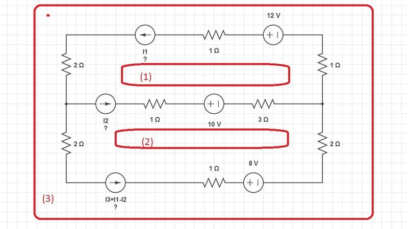

Apply the loop rule to two of the three loops to calculate I1,I2,and I3.
Picture of DC circuit involved
Circuit schematic with three loops marked (1), (2) and (3), containing sources labelled 12 V, 10 V and 8 V, resistors 2 Ω, 1 Ω, 3 Ω, and currents labelled I1, I2 and I3=I1-I2.
V=IR
L1=2v+2I2-4I1=0 (simplified)
and
L3=4-4I1-5I3=0
But if you work through the algebra you'd get
I2=1
which would then make
I1=1
which does not work for the junction rule of
I3=I1-I2 cause that is 0.
The rules still confuse me when look at some of the resistors on the right side I can tell which way current flows, obviously did it wrong though, any help would be appreciated.

mastervivi said:
3. The Attempt at a Solution
loop 1 --> 2v+2[/color]i2-4i1=0 (simplified)
1Ω + 3Ω ≠ 2Ω
Okay, re-attempted using loop one and loop two, does, this seem more accurate?
L1=12V-I1(2)+I2(1)-10V+I2(3)-I1(1)=0
L1=2V-4I1+4I2=0
L2=-3(I2)+10V-I2(1)-I3(1)-8V-I3(2)=0
L2=2V-4I2-5I3=0
L2=2-4I2-5(I1-I2)=0
L2=2-4I2-5I1+5I2=0
L2=2-5I1+I2=0
So from there
I2=5I1-2
Finally plugging it all through
I1=I2+(1/2)[From the first loop equation]
I1=5I1-2+(1/2)
I1=(3/8)
if that's true
I2=5(3/8)-2=(-1/8) [Is a negative current okay?]
and from there
I3=I1-I2=(3/8)-(-1/8)=1/2
The negative current for I2 feels wrong, did I mess up any of the loop equation or any algebra along the way?
For the second loop, it should be +5I2, not -5I2
As for there being a negative current, it just means it's flowing in the opposite direction from what you set it up as in the problem.
Okay, think I got it
You're right it should be +5I3 because it's with the current, just like I2 works out in the first loop equation

correct
quick note: you had I1=I2+1/2, so you could have easily figured out I3 right then and there. I3 = I1-I2 = I2+1/2-I2 = 1/2
