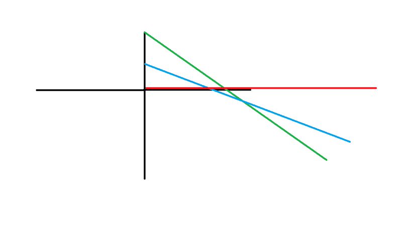

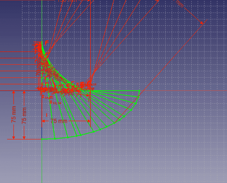

1. Homework Statement
So I am designing a machine. the issue is I have to calculate like 8 things and the maths is floating in my head but I can't get there.
the requirements are that X axis squared + Y axis Squared = 75 Squared.
then project a line out another 75 from there to get the arc I am referring to. I have included 2 rough attempts at trying to find the arc but no maths involved.
now the vertical line will always be above the horizontal. but the horizontal can go + or - 75
to equate the points pythagoras... to equate an arc from this... My brain is overloading
I got some pics for ya

Welcome to pf.
There will be two points, one on the x and one on the y axis.
By Pythagoras, the line that joins those two points has a length of 75.
The angle of that line is not specified so consider the locus of all possible positions for that line.
If you extend that line by another 75 in the same direction, (say at the x end), the extension will trace the points P( –y, 2 * x ).
Google "ellipse mechanism"
https://en.wikipedia.org/wiki/Trammel_of_Archimedes
You know that the extension is the same length as the hypotenuse line = 75.
The semi-major axis of the ellipse, a = 75+75 and the semi-minor axis, b = 75.
Find the general equation of an ellipse in Cartesian coordinates, in terms of x, y and a, b. wikipedia?
You can then write the equation of an ellipse from that information alone.
What would happen if the extension was a different proportion of the diagonal?

I have rethought the idea.now the vertical axis had to be stationary. this is because the home must always be the same in x y and z. Z is not moving so I only have x and y to move. as the pivot point is the middle point I will use the bottom point to move the item backwards and up. now I have a lot of maths to play with
