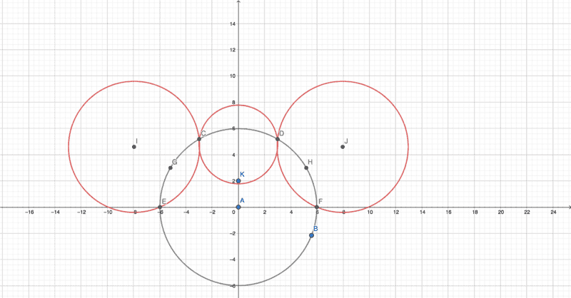

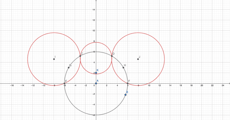

As @hmmm27 said above you can use circles of different radii to adjust the bulge. I wasn't sure if the points are equidistant around the arc as drawn here but if not it is easy to adjust for that. But these are all circles with different centers so the equations are easy. The object comes in from the left at ##E## and leaves at ##F##.
Geometry diagram on a coordinate grid: a large grey circular arc centred at A near the origin, with points E, F and B marked, and smaller red circles labelled I, J and K forming the bulged outline.
Update: I'm calling this the Mickey Mouse version...

Those circles appear to have “only approximately equal” tangents at the intersection points. That may be good enough.
(For the matching of tangent lines for circles, the centers and the intersection points should be collinear.)
How strict is the requirement (that is, what is the tolerance ) for matching the tangent lines?
