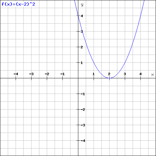

I got this graph, but unable to calculate the distance travelled.

Alright.Now,since distance is asked,you could break up the motion into two parts.Depending on the direction in which it is moving.Then you could solve them separately.
Why not? What does y-axis say?
thank you. But I am not able to calculate the distance in first 2 seconds and next 2 seconds with a formula.
If I replace t with 2 in the formula it becomes zero.
Y axis shows: at 0 second 4, at 1 sec 1 and similarly at 2,3, 4 it says 0, 1, 4 again.
Does that mean total distance is: ?10m

Yes,what does it tell you about the directions of the motions?
Though it would be more efficient if you understood and used the graph method.

But the answer isn't 10.It's 8..
No.
Clear it again. In 0 second, it is 4. That does not mean it traversed 4 meters in 0 sec.
Remember, distance is the scalar and displacement is vector. So, in displacement you can use angles and positive negative signs for opposite directions. But for distance, it is sum of all separate displacements along all the directions neglecting the sign.
So, look at the graph and think again.
Yes, answer is 8. You can do it seeing graph. Add the displacements neglecting the signs
Y-axis actually shows from 0 to 2 seconds the displacement is (-4) and from 2 to 4 seconds it is (+4).
So, distance is |-4|+|+4|=4+4=8

How would explain this? things confusing me were
1) how can a particle move in 0 seconds to 4 meter
2) If you break the journey: at 1 second it comes down to 1 (meaning 3m) at 2 second to y=0 (meaning another 1m) and then back up again. Is that correct?
3) If yes then if there is large number for example x is 20 how would we calculate.
I am grateful for your input.
thank you for your input and precious time. It is interesting to me.
1) Suppose you are sitting and an ant is coming towards you. It is now 4m apart from you when you started to count the time. So, its initial distance from you is 4m. So, at time t=0, it didn't cross 4m, rather it is 4m away from the co-ordinate system with you.
2) Now it is coming with a velocity of 2 m/s (though large for an ant). So after 2 minutes it is 0 m from you. So, it's position is 0 from origin (you)
3) Let then it went 20 meters more after 10 mins. So, total distance by it, is 24 meters, and right now it is 20 meters from you.
I think the motion of the particle for the function is unidirectional. It is just once left and another time right to the co-ordinate system.
Sorry, it is double directional for your function. Something like, after the ant crossed you, it changed its direction and turned back. So, after 10 minutes it will go 20 m away from you again. Displacement for it is (4-20)m = -16 m. Here, negative sign means the displacement is opposite to its initial direction. And distance=|4|+|-20|=24m
