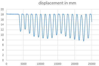

Thank you very much for the reply. I apologize for not putting any graphs, I should have thought about that. I added it to the file and uploaded it to this reply. Hopefully it posts.
The displacement data is captured by LVDT. The reason it doesn't start at zero is that it wasn't zeroed out. The person collecting the data forgot to do that but since we are interested in peak to peak displacements, that didn't matter.
As for what we are using this for. This is used to study chiropractic thrusts on the back of sheep. The thrusts are done mechanically by a device. Accelerometers are attached to the vertebrae and device. We are interested in calculating the displacement of the vertebrae which should be about half to 1-2 mm at the most. However, to make sure out methods are correct, we wanted to see if the displacement of the device would be similar or even in the ball park of displacements calculated from the Accelerometer attached to it and the LVDT.

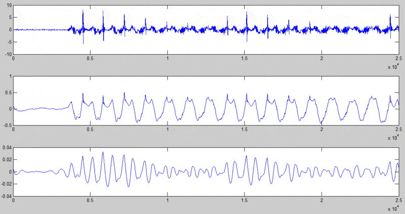

Are there particular steps to test the potential causes? I attached an image of what Matlab gives me. On the top is the acceleration data, in the middle is the velocity, and the displacement is at the bottom. The displacement is in meters so peak to peak displacement is approximately from -0.025 to 0.025 giving me a 0.05 displacement which doesn't make sense.
Again, thank you very much!
