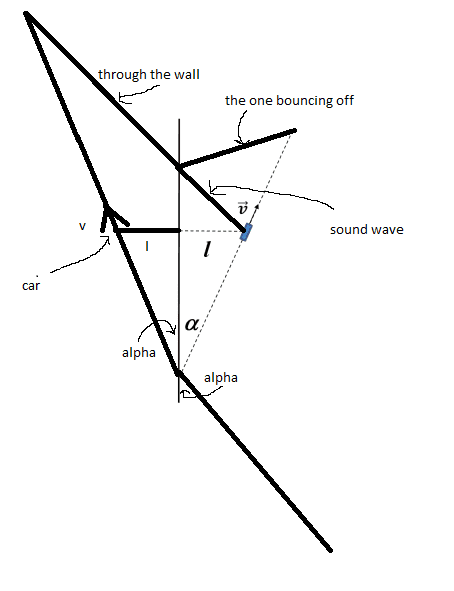

Try my mirror approach. Draw the wall and the path of the car. Project the path of the car backwards to where it meets the wall. Draw the mirror image of the car's path, taking the wall to be a mirror. Draw the path of a sound wave that leaves the car at its initial position, bounces off the wall and reaches the car at its final position. What happens if you project that path of the sound wave through the wall instead of bouncing off?
I've drawn something up that resembles what I think you mean. I haven't drawn it perfectly, as it's in paint, but I assume there are similar triangles or something I should be noticing. But first I want to check if this is how you intended?
That's about right, but you have drawn the rebound angle very inaccurately. Compare it with the path through the wall. Shouldn't they have something in common?

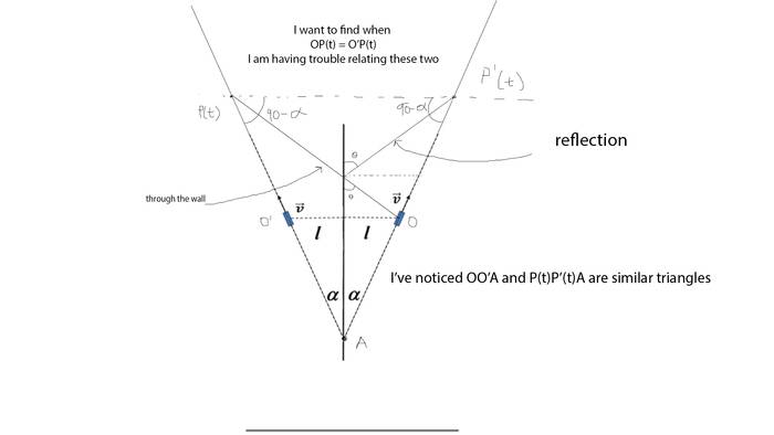

Okay, so I've drawn on paper that setup, and have gotten some pretty good insights I think. Where the car is initially I've labelled ##O##, where the mirror image of the car is I've labelled ##P(t)##. I want to find the point at which the line segment ##OP(t) = ct##, but I've run into trouble actually describing ##OP(t)## in a usable format.
I've gotten other advice from people that the angle at which the sound bounces off and reaches the car is 45°, but I'm not convinced, because it says that the distance the sound travels to the wall is the same as the distance it travels back to the car. Which doesn't look right, though that could be due to the way I've drawn my triangles. If the angle the sound bounces off is 45°, it is rather nice because that means the distance the car has to travel is the distance to the wall at the start, l.
I noticed that in attempting to describe ##OP(t)##, a lot of the angles I assumed were constant actually vary with time. It also seems massively complicated to find the length of this line segment. I just want to see if my reasoning so far has been correct.

No, the angle will not in general be 45 degrees. It's the same light, which follows what rule?
Light follows the law of reflection (coincidentally we proved the law of reflection for the first problem of this set), which says that the angle with respect to normal is the same going in as it is going out. So if the angle was alpha going in, it would be alpha going out. I have redrawn the triangle to say what I am thinking. I need help deducing what the distance the car travels is and how it relates to the distance the light travels (other than by t), If only these were right triangles, I could easily use the Pythagorean Theorem.

Yes, that's the diagram we need.
You know lengths AO and AO'. OP = vt. Don't worry for now about the fact that we do not know t. To complete the triangle, how far is O'P?

I messed up my primes, I meant the primes to be on the left. Oopsies, but I think you understood anyway.
O'P should be ct away. That answer seems to be too obvious though, does it have to be in terms of l, α, and v?

ct is right. So now you have expressions for the three sides of that triangle in terms of the parameter t. You also have an angle. What equation can you write?
