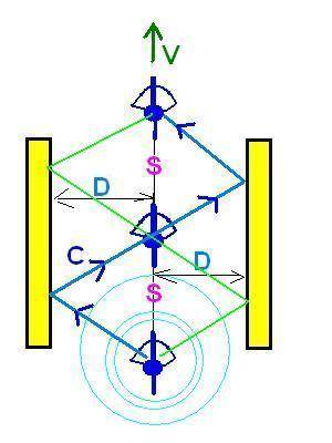

To make easier to imagine, see picture. The motorist drives just in the middle of the road between the pair of long buildings, at distance D from both, with speed V=36 km/h. He hits the horn: the sound travels in every direction and reaching the wall of the buildings, reflects. A narrow beam of sound wave reaches the middle of the road just as the motorist also reaches there, Δt=1 s later as the horn was hit. The motorist traveled S=VΔt distance. How long distance traveled the sound during that time if the speed of sound is 330 m/s? The path of the sound and that of the motorist make an isosceles triangle. What is D then?

The distance traveled by the motorist in interval 1 s = 10 m
The distance traveled by the sound in interval 1 s = 330 m
D = √(52 + 1652) = 165.076 m
a. distance between building = 2D
b. he will hear the second echo 1 s later ??

Check it. Is D the hypotenuse?
ehild
ehild
Oh yes, I see my mistake.
For answer (b), am I correct? I think the answer will be 1 s because the motorist and sound undergo uniform motion
Yes, of course, the second echo follows the first one after 1 s.
ehild
