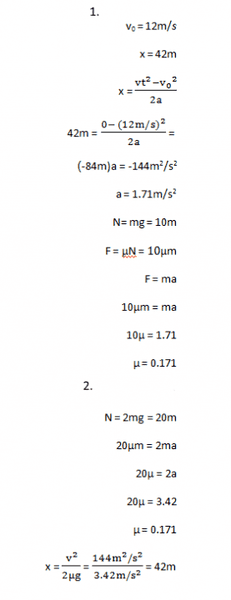

Hi, would like to get a feedback on my answer to this question, did I do it right?
In part 2 of the question is there another way to calculate distance with friction?
the question is:
a disc is moving on icy surface has an initial speed of 12m/s 42m until it stops
1. what is the friction coefficient?
2. if you take a disc made of the same material as the first and moves at the same initial speed but has double the mass how far would that disc go?
ty!

Handwritten worked solution with two numbered parts: part 1 derives a = 1.71 m/s^2 and mu = 0.171 from v0 = 12 m/s and x = 42 m; part 2 uses N = 2mg and gives mu = 0.171, ending with x = v^2/(2 mu g) = 42 m.

You are correct. However you substituted values too early which made things a bit harder than necessary. If you hadn't done that then for Q1 you would arrive at the equation...
μ = Vo2/2gx
then substitute values to give μ = 0.17
For Q2 you can simply rearrange the equation to give...
x = Vo2/2gμ
from which you can see that x is independent of the mass.
PS: The more mass the disc has the more inertia it has so you might expect it to go further BUT the friction force is proportional to the normal force which depends on mass. So mass ends up cancelling.
PPS: It's not unknown for examiners to give you lots of unnecessary information and if you substitute values early you can end up wasting a lot of time (and accuracy) if it cancels out of the equation.

yes, I wondered about that but the other way around, thought it will travel less, it seemed to make sense intuitively - that heavier objects will travel less distance, obviously it doesn't - why? is that due to inertia as you mentioned?
