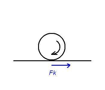

The energy is not conserved. When the spinning wheel gets into contact with the road, its surface skids with respect to the road. The force of friction decelerates rotation and accelerates translational motion. When the translational speed v is equal to the linear speed of the rim, ωR, the wheel begins to roll without slipping, the friction becomes static.

This is only possible if the interaction is similar to an 100% elastic collision. The surface of the disc and or plane would deform at "impact" and then recover with zero loss of energy. Since the interaction is 100% elastic, the disc would not stabilize, but instead oscillate through a combination of linear and angular acceleration / deceleration cycles. I don't think there's a solution here. The total energy is constant if the potential energy of the deformed surfaces are included as part of the total energy.
The more realistic and more common form of this problem assumes that energy is lost to heat while the disc surface slides on the plane. For this case, you assume that kinetic friction is constant, generating a linear force in the direction of motion, and a torque reducing the angular velocity of the disc until it transitions from slipping into rolling.
As you imagine the process it is correct, with one exception: The kinetic friction consumes energy. Some of the rotational energy is converted to translational energy and heat. The mechanical energy is not conserved.
The motion of the wheel can be considered as translation of its centre of mass (CM) and rotation about the CM. The CM is accelerated by the net force F according to
F=ma
and the rotation is accelerated by the net torque τ according to
τ=Iα
where a is the acceleration of the CM, α is the angular acceleration, m is the mass and I is the moment of inertia with respect to the CM.
The force is the kinetic friction now. It is constant so the CM performs uniformly accelerating motion, How does the velocity V change with time?
The torque of the friction accelerates the rotation uniformly. How does the angular velocity ω change in time?
Compare the linear velocity of the CM to the angular velocity of the rotation. When V=rω the wheel starts to roll without slipping.
