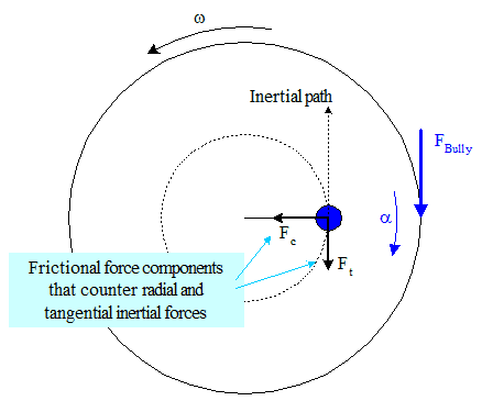

gneill said:
Don't look at gravity yet. That will come in when you look at the friction force itself. For now deal with the radial and tangential forces which are not vertical and do not involve gravity.
Only the mass of the child is of interest here. We don't know how massive the disk is or what its moment of inertia might be. That's the Bully's problem to deal with as he musters enough force to cause some acceleration ##\alpha##.
The disk is accelerating (slowing down) and for the child to remain in the same location on it she must slow down too. So friction provides the force between the disk and her to accomplish this. By Newton's 3rd law the force accelerating her is matched by the so-called inertial force of her mass resisting acceleration.
Okay, so Ft = mchild⋅ra, and then we sum all the forces together to find a?
You definitely want to sum the components to find the total force required to keep the child pinned in place on the disk. How will you sum these components?
∑F = Ft + Fc - Fs
No.
Centripetal force is not an applied force. It is that resultant of the applied forces which leads to the centriptal acceleration:
##\vec F_c=\Sigma\vec F=\vec F_t+\vec F_s##
I note that there has been a change of notation in the thread. Originally you defined Ft as the force applied by the bully. Now it is being used for the tangential force applied to the girl, and the bully is applying force Fbully. That's ok, just as long as we all understand that.
ΣF = mrα + mω2r - μsmg
The static frictional force only equals μs multiplied by the normal force (mg here) when just about to slip. Of course, here you are interested in the case where it is about to slip so the equation is valid; just pointing out that it is not in general true.
Also, you may be confused that gneill seems to be taking quite a different approach from mine. It's just a matter of the order of steps. At some point, we have to connect Fbully with Ft, and connect Ft with α. I was starting with the first of those, whereas gneill has started on the second. Both have to be done.

Let's pause for a moment to recap.
The current situation is that the child is located at radius r = 0.500 m, the disk and child share rotational velocity ω = 2.00 rad/sec, and BB (Big Bully) is causing a fixed angular acceleration (currently unknown magnitude) α in order to stop the motion as quickly as possible.
The most expedient way forward is to draw a diagram showing the forces acting. Note that these will be Cartesian vectors, or at least vector components. So you'll need to be able to convert angular quantities to linear ones as required. Recognize that the centripetal force is provided by friction, as is the tangential force that keeps the girl's linear (and angular) speed equal to that of the disk at her location on it.
Then write expressions for the magnitudes of these forces. Then write an expression combining those into one equation that needs to be satisfied.
So let's start. For the child:
What is an expression for the magnitude of the centripetal force that must be operating? ##f_c = ~~?##
What is an expression for the magnitude of the tangential force? ##f_t = ~~?##
What is an expression for the magnitude of the maximal static friction force? ##f_f = ~~?##
Now, how are they related in this problem? Remember that these are vector magnitudes. You should be able to pencil them in next to the force vectors that you drew on your diagram.
