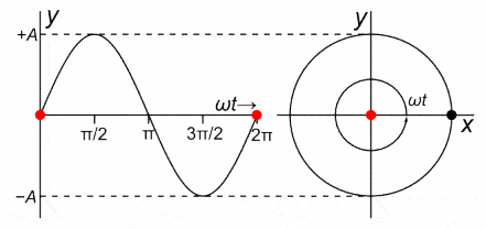

Could this be what the question means (disregarding the difference in distances between perihelion and aphelion)?:
https://en.m.wikipedia.org/wiki/Earths_orbit
Side-by-side diagram: left, a sine wave plotted as y against ωt from 0 to 2π, with amplitude +A and -A marked and red dots at the zero crossings; right, a circle with a red centre dot and a radius marked ωt, with a black dot on the x-axis, showing the reference circle for uniform circular motion.
Yes. I agree with this interpretation. The far-away observer is looking at the orbital plane on edge, and, to this observer, the Earth seems to be oscillating horizontally in simple harmonic motion caused by an invisible spring. The oscillation is about the "equilibrium position" at which the Earth and sun are aligned with his line of sight, and the amplitude of the oscillation is the radius of the orbit.
