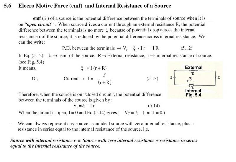

Hi, thanks for your response. I'm not sure I understand the difference. I searched but I haven't found any reference to the words "back emf" in the course material. I was a bit surprised by the word "motor" because it doesn't show up anywhere in any of the assignments until now nor in the course pack. I looked up definitions of "motor" online but what I found seems to be beyond the level of the course.
The only mention of "emf" in the course material is this:
Textbook page 5.6 on emf and internal resistance of a source, with equations 5.12 to 5.14 and a small circuit diagram (Fig. 5.4) showing an external resistor R and internal resistance r in series with the emf source.
The way I approached this problem was just to note variables as I read it, so I set:
Current = 6 amperes
Internal resistance = 0.5 ohms
Voltage = 120 volts
Is this wrong?
  • Textbook page 5.6 on emf and internal resistance of a source, with equations 5.12 to 5.14 and a small circuit diagram (Fig. 5.4) showing an external resistor R and internal resistance r in series with the emf source.
View attachment 224223The way I approached this problem was just to note variables as I read it, so I set:
Current = 6 amperes
Voltage = 120 volts
Is this wrong?
As I posted, the section of text you quote is for a source of power, such as a battery. Here we are dealing with the other side of the picture, the consumer of power.
Did you google "back emf"?
Crudely, you can think of the motor as being two resistors in series, the "internal resistance", which is not useful, and the useful load resistance. It is the second which represents the back emf. (I say crudely because a back emf is not the same as normal electrical resistance. It is the motor behaving as an electrical generator, creating a voltage that opposes the applied one.)
From the perspective of the external circuit, how would those resistances relate to the voltage across the terminals and the current that flows?
I googled it but what I found was talking about Lenz's law... is that the right thing? We kind of skipped Lenz's law, except for the equation Ei = (-1) I / t where Ei is the electric field induced by a current.
If I understand your example, the back emf would be the second resistor that is in series with the internal resistance? Does this mean that, basically, part a and part b of the question give the same answer?
