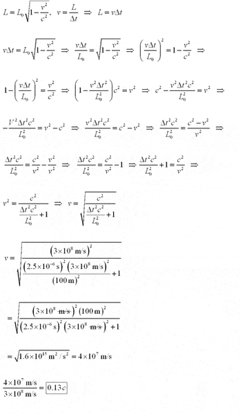

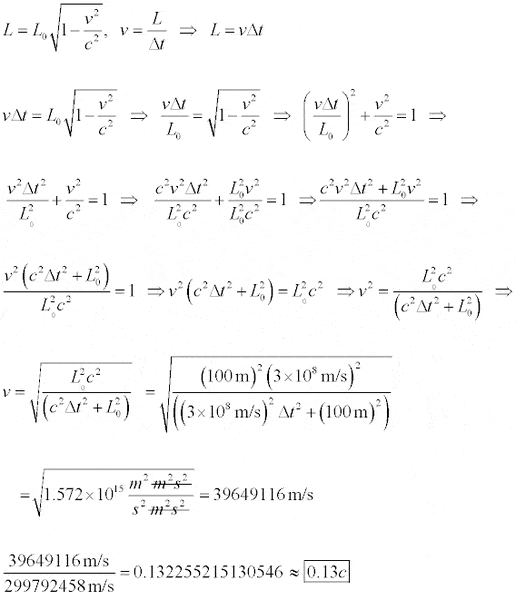

Thanks. I think I got it. It's more algebra than I though it would be. Can someone double-check that I did this right?
It's correct,although you seemed to be going in circle with your algebra for a little while there...it would have been easier for you to collect the terms that had V^2 on one side of the equation and the rest of it on the other right from the end of your second line of calcs...it probably would have saved you 3 lines or so of algebra.
You're right. It saved me 3 lines. Thanks!... More relativity q's tommorow...

I get a different answer when I do the algebra the way you recommend.
I'm recomputing the answers using a more exact value for c:
first method:
sqr(299792458^2*100^2/((2.5e-6)^2*299792458^2+1)) = 39999964.3952457
second method:
sqr((100^2*(299792458)^2) / ((299792458)^2*(2.5e-6)^2+100^2) ) = 39648636.4200608
Assuming the first answer is correct, I can now compute the length of the rocket as viewed from frame S:
100 * sqr(1-39999964.3952457^2 / 299792458^2) = 99.1058843255855
Assuming the second answer is correct,
100 * sqr(1-39648636.4200608^2 / 299792458^2) = 99.1215910501519
In each case, the rocket contracts by about 0.9 meters, but the answers are different enough that it worries me.

tony873004 said:
First method:
99.1058843255855 / 39999964.3952457 = 2.47764931354201E-06
Second method:
99.1215910501519 / 39648636.4200608 = 0.0000025
I'm guessing that this implies that the 2nd method is correct, since I get back the exact value of the given time. But that would mean that I must have made a mistake in the algebra of the 1st method, although I can't find my error. Usually algebra errors give answers that are way off, not nearly-identical.
There is a slight error on your first calculation; when going from line 7 to line 8, you didn't multiply the 1 in the denominator by (100m)^2...It didn't affect your final answer much though because the first term in the denominator works out to be 1.875 X 10^7 m^2 which is much bigger than the 10^4 m^2 term. This is why it's usually best not to play around too much algebraically, there are more places to make an error.
Thanks. No matter how many times I stared at that, I just couldn't see it. It's obvious now that you point it out.
