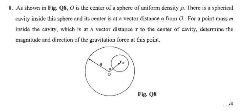

The question is presented as picture.
We do not have the radius of the cavity and the position of the m. How can we find the force acted on it?
r=1/(M-m)*Ʃmr=1/(M-m)*4/3ρR'^3*r where m is the mass of cavity ,R' is the radius of the cavity and r is the position of center of mass. But I can't find R'.

Can you solve this problem if there was no cavity? If so, perhaps you can think of a way to model the problem so that the force on the point mass is the sum of two contributions, one from the big sphere and a "negative" from the small sphere?
