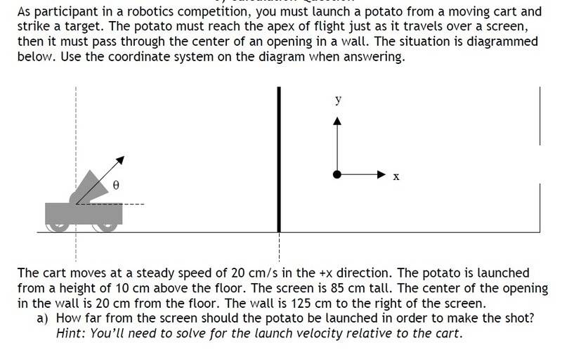

doc2142
See image
See image
I have tried, but I honestly have no Idea how to start this problem.
  • Physics problem diagram: a cart with a launcher at angle theta moves right on a floor toward a vertical wall with an opening, a screen to its right, and a coordinate system with x and y axes; the problem text is printed above and below.
Start by listing kinematic equations that might be useful. What's the maximum height of a launched projectile? How much time does it take to reach its maximum height?
The problem doesn't explicitly say what height the potato may have when it passes over the screen, so I suppose that you could assume that it just clears it at the screen's height.
Hint: can you find the equation for the trajectory of a "reverse" potato launched from the center of the wall opening and just clearing the screen?
I am a bit confused about your hint. a reverse? what is that exactly mean like wouldn't it need a velocity to go from the hole in the wall to the top of the screen?
Yup. One property of projectile motion is that its trajectories are "reversible". You can launch a projectile and plot its trajectory to its landing point, and if you note its landing angle and speed, you can launch it from there back along its trajectory by using the same speed and angle to do so.
So what velocity (x and y components) would take a potato from the center of the window to the top of the screen as the trajectory apex?
Could you simplify this somewhat by removing 10cm of height from everything, setting your axis inline with where the projectile begins? Then perhaps consider the system as symmetric about the screen?
Yes! Those are two easy simplifications that hardly require any elbow grease to carry out :smile:
