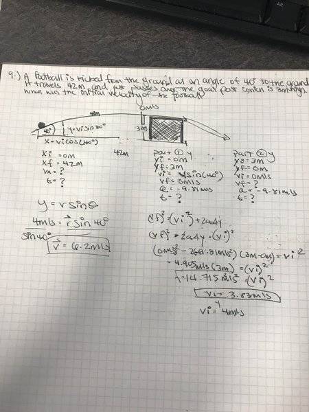

A football is kicked from the ground at an angle of 40° to the ground. It travels 42m and just passes over the goal post which is 3m high. What was the inital velocity of the football?
vfinal2 = vinitial2 +2a(yfinal-yinitial)
Assuming that the football from the start to finish creates a symmetric parabolic line, I realize that when the football reaches it's highest point, it stops gaining velocity and has an acceleration of -9.81m/s2. With that information, I set yinitial = 0m and yfinal = 3m. From there, I used the equation above to find vinitial (rearranging the formula to have vinitial2 = vfinal2-2a(yfinal-yinitial) , (numbers plugged in.. vinitial2 = (0m/s)2 -2(-9.81m/s2)(3m-0m)) and got vinitial = 4m/s in the y direction. Knowing that velocity in the y direction = velocity(sin(Θ)), rearranging the function to yvelocity/(sin(Θ)) = velocity, I got 6.2m/s as initial velocity of the football. I appreciate any feedback.
Picture of my work
Where did you include the total travel distance of 42m?
I deleted my first post since I worked the problem with 42m travel and then realized I had not invoked the 3m goal posts height! So - my hint is that you can combine 42m length and 3 m height if you (1) don't assume that 3m is the highest the ball will ever go, and (2) that you realize that you have an extra independent variable, to wit, the distance between where the football is kicked and the goal posts.

OK, this may be my last post on this, I will try to summarize the situation but you have to provide think power too!
1. Compute v to get a total distance of 42m. This is actully the answer to the problem, but you won't learn nearly as much if you leave it at that.
2. So how about you compute the max. height the ball would reach. I think you'll find that that's quite a bit higher than 3m.
3. So, here's the fun part, and it is not that hard: what do you have to do to make the ball just barely clear the goal posts? Draw the parabola with 42m distance and the compute max. height at the top, then put marks at 3m height on the parabola, then what would you do to just clear the goal posts?
(I've given you a hint before as to what you might want to do.)

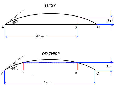

Please, for my benefit, which problem is to be solved?
rude man said:
If you assume 42m distance you get max football height at 42/2 = 21 m from the kicking spot, right?
Suggests the bottom problem.
View attachment 210816Suggests the bottom problem.
Good point. The problem statement is a bit ambiguous. I assumed the bottom one as you do.
If 42m is to landing on the ground then the information about clearing a bar at 3m cannot be relevant. We can fit the location of the bar to whatever trajectory we come up with, provided it rises to at least 3m.
Of course, the 3m might have been thrown into provide an exercise in deciding which information is relevant, but more likely it is because the 42m is supposed to be the horizontal distance to the bar.
@HRubss, have you stated the question word for word?
In American football, it is the usual case that you know the distance to the goal posts from the spot at which the ball is to be kicked.
Therefore, I suggest that the upper sketch may well represent the problem to be solved. It seems to me that this makes the problem only a bit more challenging.
