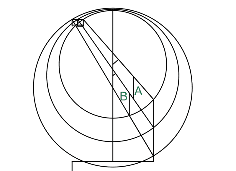

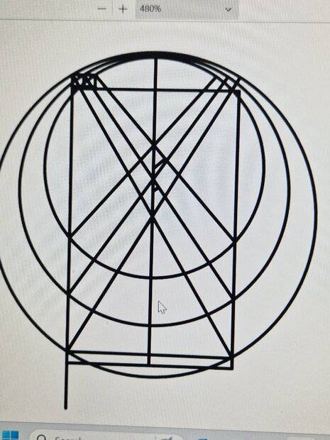

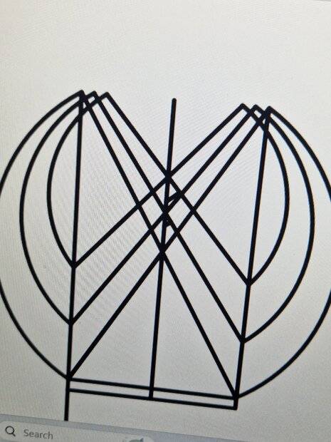

carman435
29
Calculate the position and length lines A & B would be to allow for a full rotation into the opposite position.
I'm really unsure! I'm currently looking into four bar linkage but I am not sure it is relevant
Hi, i need to find a formula or calculation that would allow me to connect three lines when rotating. The three lines must fall so that they mirror themselves on the opposite side.
I need to be able to calculate this for now just the example above but be able to apply to a range of lengths and heights.
Any help in terms of connecting three rotating objects would be nice as I'm at a total loss here.

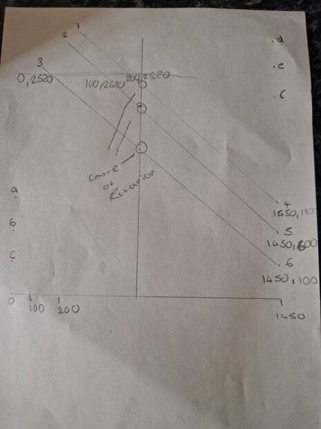

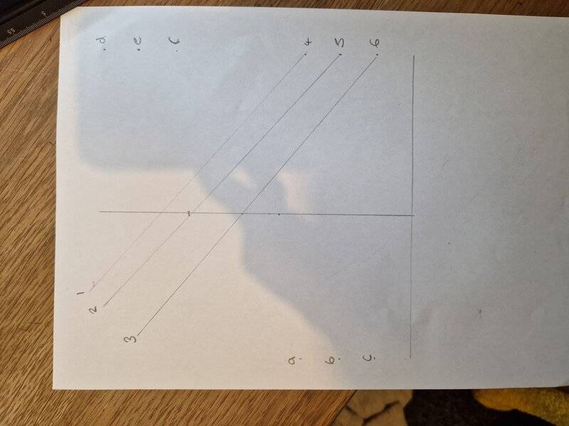

Hi sorry its my first time and I don't think I've been very clear. Here's another clearer drawing.
Point 4 will move to d
point 5 to e
point 6 to f
Point 1 will drop to a
Point 2 to b
Point 3 to x
I need them to do this in tandem. When the bottom line is move all three need to move equally. I'm trying to connect the three lines by attaching a connector from 1,4 to 2,5 and a connector from 2, to 3, 6
I'm not sure where to place the connectors so that they rotate without getting stuck nor am I sure what length they need to be. I have no idea where to even being in terms of looking for math to help this.
I hope that helps and thankyou for any help you give.
I assume this is a 2D problem.
Draw each line in its initial and final position. Where the lines cross themselves, could be a stationary point on the line, as it rotates.
Those three stationary points could be connected with fixed length connections.
If you could identify the correct question, you could answer it yourself.
We must find the correct question to get the right answer.

Hi ive updated it to the best of my ability. I usually use Cad to do this sort of thing so the drawings a bit rough and not to scale at all. But it should show what I'm trying to achieve.
Thanks again for your help.
To add to this the , is a separator so the coordinates would be Horizontal 0 Vertical 2520
The lines all have different lengths: 2029.507, 2347.104, 2723.765
The lines all have different slopes: -44.401°, -54.887°, -62.682°
We know the lines rotate about three points on a common vertical line. We do not know the x coordinate of that line, so we cannot find the coordinates of the centres of rotation.

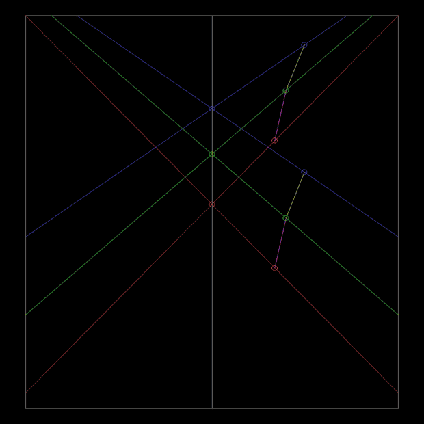

As a follow up to this. I've looked a tad at four bar linkage. I believe a set of constants would help, if I were to decide on a a point across each each bar. Say 100 in from the point 1450, 100 etc etc. Then use this as the first point of my linkage I believe using the angles of the bars at these points I should have sufficient information to create a three bar linkage which I think this actually is.
I think it's two sets of interconnected three bar linkages. No idea how that works but I'm going to have a go. Thanks for your help. If you get any idea of how to calculate this I'd love to hear it.
As a further follow up. I think it's actually two sets of four bar linkages.
I believe if I can set a constant on the upper bar as a point of connection. I can calculate the linkage required to connect to the middle bar.
I can then set a similar constant on the middle bar and connect to the lower bar. Along as these don't adjust the rotation of the bars which they shouldn't it shouldn't really matter where I set my constants I believe. Along as I get the formulas right I believe I can calculate them independently of each other.
The line between two centres of rotation is a bar, so it is a 4 bar linkage.
It is easy to pick a point on the first bar. The difficulty is finding the point on another bar that is separated by the same distance in both end positions. You need to solve a system of equations to find both the distance along the second bar, and the length of the connecting link.
I'm assuming there isn't a standard formula that uses the length of the bars and the angle to find an appropriate linkage?
Not in this case, since the end-points of the rotation are not directly defined. The solution to linkage problems often comes down to the intersection of two circles.
Ah the end points of the rotation are defined. I think?
The points should rotate until they fall into their opposite positions. Point 0,2520 will rotate into position 0,100

I think I'm confusing things here.
Effectively what I'm looking for is the formula to calculate the coupling position and the lengths they are.
The starting points of the rotation shouldn't matter for me as I can adjust them in the formula (I think)
The end points again shouldn't matter. If I'm not mistaken the end and starting points should be variables that can be set in the equation, or will directly result in creation of the variables for the formula.
The rotation will always be from points
0, 100 to 0,2520
0, 600 to 100, 2520
0, 1100 to 200, 2520
And then the inverse on the opposing side
1450, 2520 to 1450, 100
1350, 2520 to 1450, 600,
1250, 2520 to 1450, 1100
The lines when drawn require an adjustment to start and end at these points. The way I've mapped them is by drawing the points from 0,100 to 0,2520 then I've taken the half way point of this line, drawn a line in the opposite angled position towards the centre line situated at 725 on the horizontal axis. The point this line intersects the centre line is The rotation point. I've attached a photo of this to help explain it as I feel I'm not very good at explaining what I'm talking about.
So the lines don't intersect the centre axis at their middle. If that makes sense. The middle piece of each line has a line coming down to connect it to the centre axis, this is to make the rotation change so that they fall into the same positions each way.

I know it's not a simple thing but I believe I have accurately managed this piece in Cad, I think I can reflect my actions in a formula if given time
