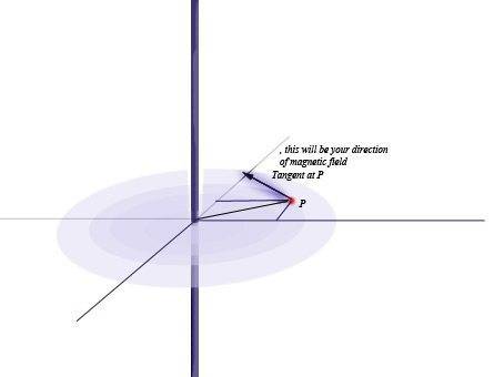

George , what will be the direction of magnetic field at that point,?
i'm not sure, I'm struggling with all this right hand rule stuff
See , you need to know is ,
The magnetic field will form concentric circles around the wire ,
and the direction of magnetic field at any point will be the tangent of the circle at that point .
This is the figure
  • 3D sketch of a vertical wire with a faint circular loop around it in a horizontal plane, a point P marked on the loop, and a tangent arrow at P labelled 'Tangent at P' with the note 'this will be your direction of magnetic field'.
