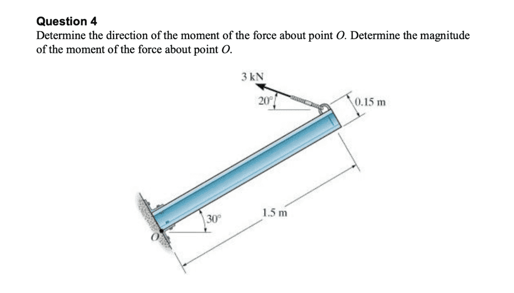

See below

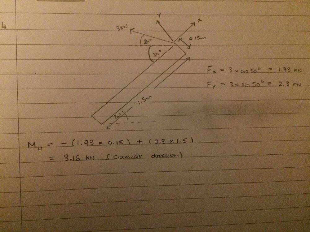

moment = force x perpendicular distance
Not sure if I answered this question right
I took my clockwise moments as +ve and counter-clockwise moments as -ve
Any help would be much appreciated! Thanks
Should ##F_x## be positive or negative?
Are you sure you took clockwise as positive for the moments? Does ##F_y## tend to rotate the object clockwise or counterclockwise?
Oh it looks like Fy is trying to rotate the bar counter-clockwise
whereas Fx is also rotating it counter-clockwise?
so let's say I took counter-clockwise to be a positive moment, then the moment about O is (Fx * 0.15) + (Fy * 1.5) = 3.74 kN?
It looks OK to me.
Yes
Looks good except for the units of the answer.
