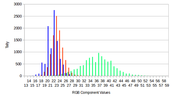

I threw in the dice example because I cross posted this question on another site that's pretty useless for answering my statistics questions. What I meant to say is that I've taken the RGB values of a single pixel, and tallied them over 10,000 frames from a webcam under static conditions. The values I got are as follows:-
I want to know how many permutations are possible for the unique values of that pixel. This would equate to how many unique colours that pixel might be. So you say that I need to set some hard limits on the values each channel can take - you seem to have implied +/- 3 standard deviations in your calculation?

Andrew, there's a histogram in my first reply to you. Can you not see it? It's my first piccy post.
Your picture is a histogram of the individual colour values - ie it's actually three separate histograms overlaid on one another and distinguished by the colours of the columns. It is not a histogram of the 3-colour combinations.

I know X because I have a histogram (shown earlier in this thread). Is the number of permutations really as simple as:-
(width of red histogram) * (width of green histogram) * (width of blue histogram) ?
So an approximation would be (33-18) * (53-20) * (29-14) = 7425 permutations /colours...
