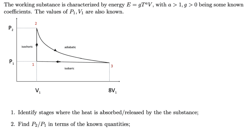

Heat Engine with working substance characterized by energy E = g T^a V, with a>1 and g>0 being known coefficients. The values of P1, V1 are also known. Find P2 /P1 in terms of the known quantities.
dE = TdS - PdV
My attempted solution is as follows:
Obviously the heat transfer happens during transitions 1->2 and 3->1.
It's also clear that
P1 = P3
V1 = V2
E2 - E1 = Integral[T dQ , from state 1 to state 2]
E3 - E2 = - Integral[P dV , from state 2 to state 3]
E1 - E3 = Integral[T dQ , from state 3 to state 1] + 7 P1 V1
But I can't find a way to perform any of these integrals or make any progress on this problem.
An attempt to calculate pressure is stuck at: p = - (dE/dV)_S = g a T^(a-1) (dT/dV)_S V + g T^a
Check the units in these equations.

One idea: I can calculate Cv = (dE/dT)_V = a g T^(a-1) V , and I also know Cv = T (dS/dT)_V which helps me know a little bit about the change of entropy from state 1 to 2.... but I'm still stuck.

I also made a little progress on this by using $$\left(\frac{\partial E}{\partial V}\right)_T=-\left[P-T\left(\frac{\partial P}{\partial T}\right)_V\right]=gT^a$$which leads to $$P=\frac{gT^a}{a-1}+Tf(V)$$
I derived the equation for entropy variation also, but I've as yet not been able to figure out a way that it can be used to provide an answer to this problem: $$dS=\frac{ga}{(a-1)}d(T^{a-1}V)+f(V)dV$$
From dimensional considerations, it makes sense to me that the function f(V) should be proportional to R/V, where R is the gas constant. If f(V) were equal to R/v, we would have $$\frac{PV}{RT}=z=1+\frac{1}{a-1}\frac{E}{RT}$$I'm unable to prove this yet, but I may proceed as if it is the case and see where it takes me.
