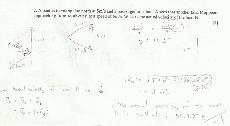

A boat is traveling due north at 5 m/s and a passenger on boat A sees another boat, boat b, approaching from south-west (45 degrees) at a speed of 6 m/s. What is boat B's actual velocity?
Vrel = Vb - Va

Handwritten solution to a relative velocity problem: vector diagrams of boat velocities, law of sines and law of cosines working giving |V_AB| = 4.31 m/s and a bearing of N 13.2° E.
  • Handwritten solution to a relative velocity problem: vector diagram with 5 m/s north, 6 m/s south-west at 45 degrees, and a triangle with sides 5, 6 and 4.31 m/s; law of sines gives 13.2 degrees, and the result 4.31 m/s, N 13.2 degrees E.

Try redrawing your triangle a little differently so that the angle is 135 degrees from the horizontal. Imagine flipping your triangle upside down.
Hope this helps
