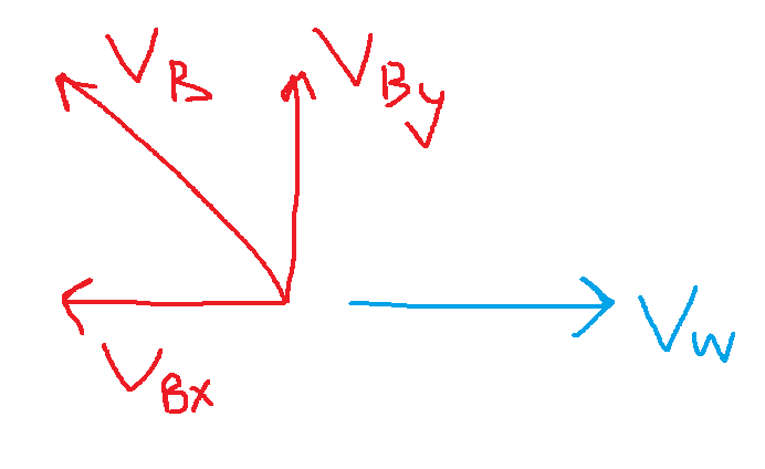

perhaps this picture will help
vw : velocity of water
vB : velocity of boat
You know three things here and can calculate the fourth
I thought V_w = V_bx in this situation. I am looking for V_B, right?
yes
Nope that one you know!

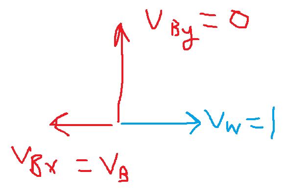

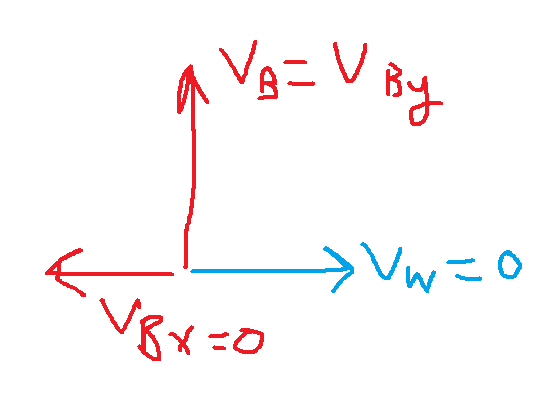

The problem said something about what speed the boat has when the water is still.
Given my picture, can you figure out which of the two things VB and VBy this number is referring to?
And yes you do not actually need to know the angle, but it is nice to visualize how the boat need to steer
