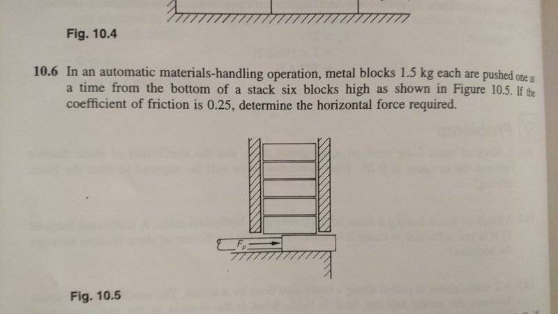

In an automatic materials handeling operation, metal blocks of 1.5 kg each are pushed one at a time from bottom of a stack six blocks high. If the coefficient of friction is 0.25, determine the horizontal force required to push. There is a figure bellow.
I try to solve but my answer is different the offered solution. Don't know am i wronge or there is mistake in solution. Making me crazyy!

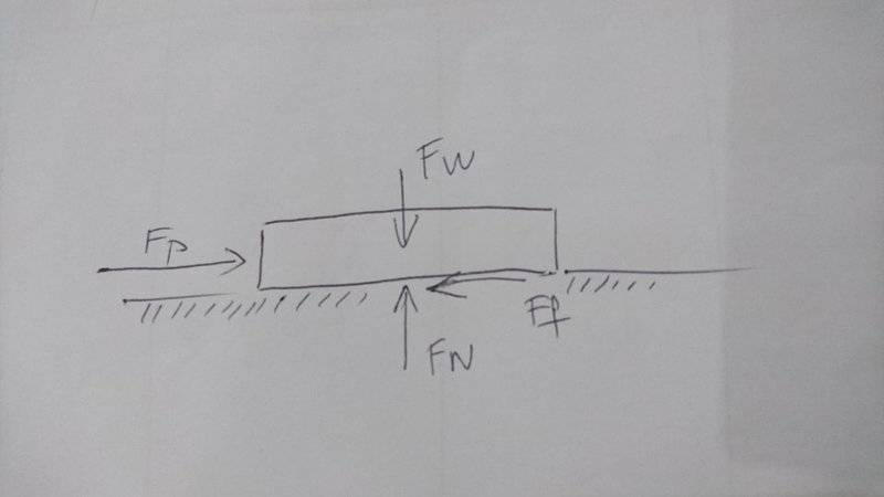

Best to use the homework template .
Anyway - show us what calculations you have done so far .
Welcome to PF. You need to post what you've done.
Sorry for color of paper!
That is very hard to read . Please type out any further workings .
How many block surfaces have friction force acting on them ?
Is normal load the same for each surface ?

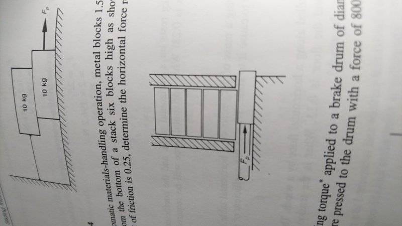

It's also not oriented correctly ?:)
There's not many equations on it; It would be better to type them in thus making it easier for helpers to help you (while saving them from going blind and suffering a neck injury from turning their heads sideways to see what you've written o0) :smile:)

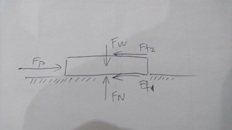

Nidum said:
How many rubbing surfaces ?[/QUOTEi
Two up and down. I try that as well again didn't come to right solution.
Draw a free body diagram for the moving block .

If we assume that friction is the same up an down 0.25!
