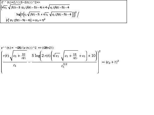

Check the attached file in the present post. It has the wolframalfa solutions it gave me a couple of days ago.
At the case which of f’’(t)=GM/((A-f(t))^2, I entered f’’(t)=2/((5-f(t))^2, The initial conditions are f(0)=0 and f'(0)=0, therefore c1=c2=0. But that solution gives...? (-4)/(-4)=t^2 and no f(t)=...?
Now it gives me the answer again! here it is:
(sqrt(c_1) sqrt(f(t)-5) (c_1 (f(t)-5)-4)+4 sqrt(c_1 (f(t)-5)-4) log(2 (c_1 sqrt(f(t)-5)+sqrt(c_1) sqrt(c_1 (f(t)-5)-4))))^2/(c_1^3 (c_1 (f(t)-5)-4)) = (c_2+t)^2
At the case of r’’(t)=-GM/((r(t))^2, if I remember well I entered GM=2 again. Here
r(0)=A and r'(0)=0, thus c1=c2=A/2. Hm...this seems to have a solution r(t)=... so the first equation is ... impossible?
It still does not give me the answer for this one now.

Wolfram Alpha is only a sub-set of Mathematica. Ver 7, gives:
DSolve[y''[x]==-k/y[x]^2,y,x]
as:
[tex] \begin{aligned}&<br /> \text{Solve}\biggr[\left(-\frac{1}{C[1]^{3/2}}k \text{Log}\left[2 k+2 C[1] y[x]+2 \sqrt{C[1]} \sqrt{C[1]+\frac{2 k}{y[x]}} y[x]\right]+\frac{\sqrt{C[1]+\frac{2 k}{y[x]}} y[x]}{C[1]}\right)^2\right.== \\<br /> &\hspace{200pt}\left.(x+C[2])^2,y[x]\biggr]<br /> \end{aligned}[/tex]
That is, Mathematica is giving the solution as an implicit inverse via the Solve function.
