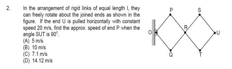

(see attachment)
I was able to calculate the velocity of point P in x direction (to the left). For the speed, I need to find the velocity in y direction (vertically up). Here is my attempt:
At t=0, the distance of point P from O is l, let at time t, the angle POR be ##\theta##. The displacement is ##y=l(\sin \theta -1)##. Differentiating this equation, ##\frac{dy}{dt}=l \cos \theta \cdot \frac{d \theta}{dt}##. The term dθ/dt is equal to the angular velocity but I don't know the radius of curvature of its path which I have to use in the formula ω=vr, where ω is the angular velocity, v is the velocity in x direction and r is the radius of curvature.
Any help is appreciated. Thanks!

How far does P get from O after t =0?
##l \cos \theta##.

You're overcomplicating things. Let ∠SUT = 2θ (so you're looking for what happens when θ = 45 deg).
Take O as the origin.
Let ##u_x, u_y, p_x, p_y## be (respectively), the co-ordinates of U and P at time t.
Can you find simple expressions for those in terms of l and θ? (except that ##u_y## is simply constant at zero).
Can you find ##\frac{du_x}{dt}## in terms of ##\frac{d\theta}{dt}## using Chain Rule? Hence rearrange to determine a numerical value for ##\frac{d\theta}{dt}## at the instant of interest.
Can you differentiate ##p_x, p_y## wrt t to find the instantaneous horizontal and vertical velocities of P?
Now use Pythagoras theorem to find the resultant speed.
Find the coordinates of P in terms of the angle. The velocity components are the time derivatives of coordinates.

Thanks a lot Curious, that solved the problem. :smile:
The velocity of P in both the directions come out to be same!

That's because the sine and cosine of 45 deg are the same! :wink:

Not the x coordinate, but the distance from O. I was just trying to point out that P moves in a circle.
Yep, didn't notice that at all. Thanks!
