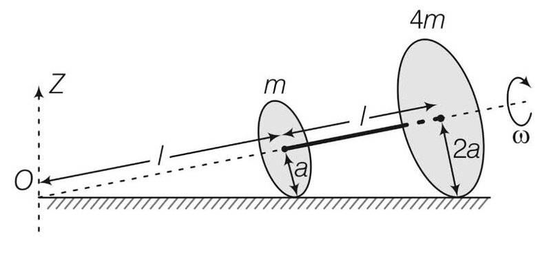

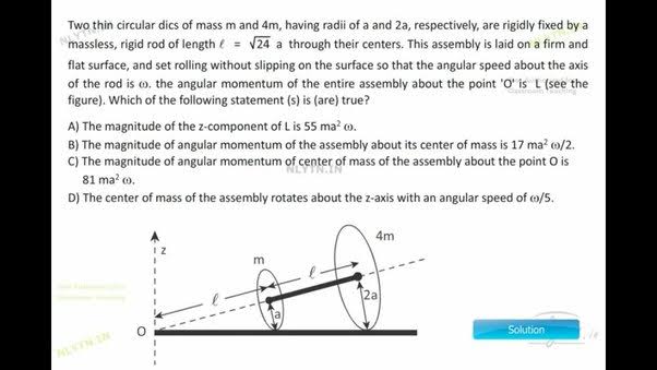

Two thin circular discs are rigidly fixed by a massless rigid rod passing through centers and laid on on a firm flat surface and set rolling without slipping
$$\vec L=\vec r\times m\vec v$$
$$\vec L= I\vec \omega$$
If I understand correctly :
The angular velocity vector has two components: one along ##\text{-ve z-axis}## and one along ##\text{-ve x-axis} ##
So the motion can be considered to be two rotations:(some animation might help)
  • Rotation about ##\text{z-axis}## with angular speed ##\omega\sin\theta##
  • Rotation about ##\text{x-axis}## which is the Instantaneous Axis Of Rotation with angular speed ##\omega \cos \theta##
Now the center of mass of system is at ##\frac{9l}{5}## from origin. So angular momentum about COM is found.
In order to find angular velocity about ##\text{z-axis}##, value of $$\sin\theta=\frac{a}{\sqrt{l^2+a^2}}=\frac{1}{5}$$
So here is a doubt:
  1. Why does the system rotate in a way where the radius is perpendicular to the axis of rotation? It's not given in the question so why the assumption?
  2. Why do the wheels tilt? Why can't the wheels be perpendicular to the surface with an axle connecting their centers? How might that motion look? Does it destabilize the system rotation or is it because of the diagram given?
  3. The angular momentum of COM is non-zero (though not what the option says) However if the COM is on the axis, it means it should have zero angular velocity and therefore zero angular momentum. This contradicts the fact that the COM has a velocity and therefore angular momentum is not zero?
1. Consider that the system is similar to a cone rolling on its side on a flat horizontal surface.
2. For that to happen, rather than zero, the z value of point O must be equal to radius 2a and should be a support of such type that it allows the axle to rotate freely about the z axis and simultaneously about the axle itself. The smaller disk would never touch the flat surface, while the vertical bigger disk would roll over the flat surface describing a circle.
3. Not a contradiction, since, as you noted, there are two simultaneous rotations. The angular momentum is about the z axis. Try visualizing yourself as trying to start pushing a very heavy cone to make it roll on its side on a flat horizontal surface.

But I was talking about the option which said:
Angular Momentum of COM about point O is ##81ma^2\omega##
The COM is a point on the axis so its angular momentum about O should be zero and all my other arguments

FWIW, this is the 'kinematics' of railway wheels on bogies etc with rigid axles.
Aurelius120 said:
But you said that happens even when axis is fixed :
So how to write?
There are three components altogether.
In post #1, you took the rotation about the instantaneous position of the cone's axis and resolved it into a component about the x axis and a component about the z axis. Neither of those involves the length L.
What that misses is the rotation of the cone's axis about the z axis. This adds another rotation about the z axis, and does involve L.

The center of mass certainly rotates with angular velocity ##\omega/5## around the ##z##-axis purely by geometrical consideration. The smaller wheel should roll around a circle of radius ##\sqrt{\ell^2 + a^2} = 5a## and the wheel itself has radius ##a##. It will therefore go around once every 5 revolutions, meaning ##\omega/5## is the angular velocity of the CoM.
Ok, I start to see where my confusion is, but it wasn't part d that I meant to query - I agree with that.
And maybe I misunderstood the OP's analysis in post #1. I read that as decomposing the rotation about the cone's axis as a rotation about the x axis plus a rotation (##\omega/5##) about the z axis. But that does not consider the rotation of the cone's axis about the z axis, also ##\omega/5##.
Rereading it, maybe what I read as the first of those was intended as the second, in which case it is the first that is missing. E.g., if the cone's axis were fixed (so slipping, not rolling) there would still be a z axis ##\omega/5## component of the angular velocity.
So part b is the one I am worried about. The given answer would be true for that slipping case. Shouldn't the precession of the axis change the magnitude of the angular momentum? (In fact, reduce it, I think.)
Yes.

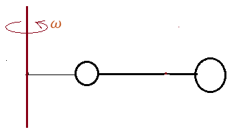

My analysis was wrong. I imagined it correctly as a pure rotation about point of contact (substitute for rolling) and z-axis but for whatever reason decided it was because of the two components of ##\omega##
So my equation was $$\vec \omega_{net}=-\omega (\cos \theta \hat i + \sin \theta \hat k)$$
Rather than $$\vec \omega_{net}=\vec \omega+ \text{ angular velocity about z-axis }$$
And that's why I thought angular momentum of COM will be zero about origin

Angular velocity does not depend on relative position as angular momentum does. The angular velocity is what it is regardless of frame.

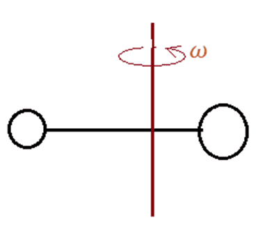

To put that into context. If you factor out the CoM motion, the axle will still precess around the z-axis. The answer given in (b) is the angular momentum of the assembly if it only spins about the axis without precessing - but as @haruspex points out: it does precess.
But it should depend on frame of reference? I mean when we calculate angular velocity, it is relative to Earth. We don't take rotation and revolution of Earth into consideration.
Similarly relative to the COM the angular velocity of the discs should be ##\vec \omega## about the axle.

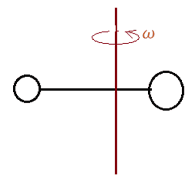

@Orodruin So if I were to sit on the axle, I will still be able to see the wheels rotating about z-axis? This seems a bit a counterintuitive
So to calculate angular momentum about COM do we take COM stationary or COM rotating about z-axis?
It is so much easier with linear velocity and linear momentum 😩
For the angular momentum about the COM, take the COM as stationary but consider all rotations about it. That means both the rotation of the cone about its axis and the rotation of that axis about a vertical axis.
So for the purpose of this question, the option is wrong
But I can't calculate angular momentum about COM now
Since about the COM and parallel to z-axis angular velocity of the wheels will be in opposite sense, does it mean angular momentum is substracted
Yes, it reduces the overall magnitude.
It is probably easiest if you resolve the angular velocities into components along the cone axis and normal to it. (Otherwise you will have angular momentum of rotations of discs about a skew axis to deal with.)
For the rotation about the cone axis, that's trivial. Try resolving the rotation of the cone axis about a vertical axis through the COM that way.
Plz Check this
This is my attempt at Option-B:
About axle :
Angular Momentum: ##L_1=I\omega= \dfrac{17ma^2\omega}{2}##
About axis perpendicular to axle:
Velocity of COM of 1st wheel about z-axis=##\dfrac{\omega}{5} l \cos\theta = \omega_1×\dfrac{4l}{5}##
Velocity of COM of 2nd wheel about z-axis= ##\omega_2×\dfrac{l}{5}= \dfrac{\omega}{5} × 2l \cos \theta##
Angular Momentum: ##L_2=I_1\omega_1 - I_2\omega_2##
So $$L_1=\frac{17ma^2\omega}{2}$$
$$L_2=\left(\dfrac{ma^2}{4}+\dfrac{16ml^2}{25}\right)\omega_1-\left(\dfrac{4m(2a)^2}{4}+\dfrac{4ml^2}{25}\right)\omega_2$$
$$L_{COM}=\sqrt{L_1^2+L_2^2}$$
