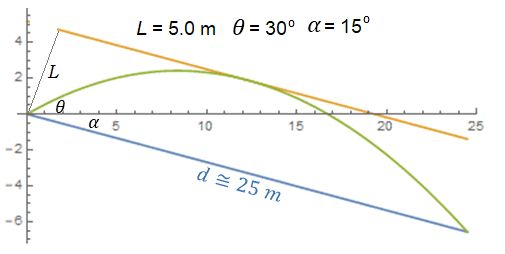

Am I understanding the setup? Here's how I see it for a specific case:
The blue line is the tunnel floor, orange is the tunnel ceiling. The trajectory is green.
For ##L = 5.0## m, ##\theta = 30^o##, and ##\alpha = 15^o##, the maximum range along the tunnel floor is ##d \approx 25## m for an initial speed ##v_0 \approx 14## m/s.
I find the general formulas corresponding to maximum range to be $$v_0 = \frac{\sqrt{2gL\cos \alpha}}{\sin(\alpha + \theta)}$$ $$d = 4L\left[\tan \alpha + \frac 1 {\tan(\alpha + \theta)}\right]$$

You understand the setup correctly. However setting ##\theta =\alpha## is not a very good idea because that means that the projectile is shot at the surface and parallel to it. Your expressions and mine are identical when ##\alpha=0## but that doesn't mean much.
The argument ##(\alpha+\theta)## in the denominator of your expressions bothers me. In my expressions the angles are positive above the horizontal and negative below. That gets the sign of ##\Delta y## correctly. So in your example, I would enter a negative value for ##\alpha## because the tunnel is sloping down.
It is entirely possible that I made a mistake somewhere. I have to recheck my expressions.
OK, that clears it up! I used the opposite sign convention for ##\alpha##. Our formulas for the initial speed and range agree when the different sign conventions are taken into account. Thanks.

All is well. Here is my plot reproducing yours.
