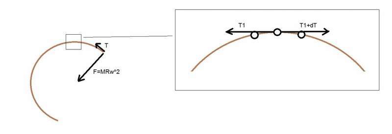

Im a bit new to this way of looking at problems by looking at them in very small parts, but it does look beautiful, so any help with getting me acquainted with it will be much appreciated! I do have the math needed, but not the intuition of how to break a problem to its infi parts.
So, since an angular velocity is mentioned, I obviously thought about a circular movement. The rope is moving along the circumference of a circle. Which means a force F must be applied to its connected end, and the force pointing to the center of the circle.
On the other hand, when I look at a very small element of rope, its a particle moving in circular motion. But what are the forces acting on it? F would act only at the connected end, wouldn't it? So the force acting on the particle is T1 towards one side tangential to the circle, and T2 towards the other tangential side? How does that explain it's circular motion? (he must have some force towards the center, not on the tangential axis)
What force causes the circular motion when looking at a very small mass particle?
Any help would be much appreciated!

I did do free body diagrams before, but those were very simple. I never did one where you need to consider infinitely many small elements. My my issue is with the specifics of breaking this problem to the little masses you mentioned. I know its the way to go, I just don't know how to do it.
I added a picture from which I don't know how to continue.

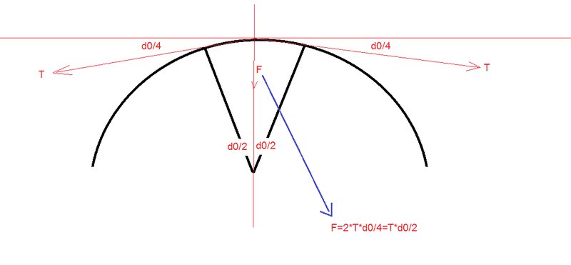

The statement of the problem is unclear to me. What does it mean "is connected in one side"? Does it form a circle? If so, there's no dT. The tension will be constant. Instead, consider dθ and dm. You have a mass dm = ρrdθ, two instances of T in almost opposite directions (difference being dθ), and a resultant centripetal force.

Sorry, I hoped the choice of letters was sufficiently standard as to be self-explanatory.
ρ is the density (mass per unit length) of the rope.
In polar co-ordinates centred on the centre of the circle, (r, θ) is the location of an element of the rope subtending dθ at the origin. Its length is therefore rdθ and its mass, dm, is ρrdθ.
The centripetal force will bisect dθ, and will be provided by the radial component of the tension (each side of the element).
Can you obtain an F=ma equation from that?
Thank you! So, if I have dm = ρrdθ I have F=ρ*dθ* r^2 * w^2, right? And there are 2 tensions causing the force F, which is T*d0/2 (I added a picture of finding F, do you mind telling me if I am on the right track?).
So 2*ρ*r^2*w^2=T?

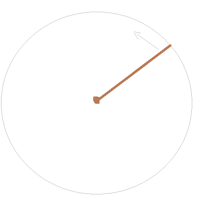

Is it possible that the question is referring to this scenario (in the added picture),
and therefore:
dm/dL = p
T-(T+dT)=p*dL*r*w^2
-dT=p*dL*r*w^2
and then somehow replacing dL with dr to get T as a function of r?
Yes, I think that may be the intent. OTOH, it means the tension is not constant but is a function of distance from the attached end. "What is the tension along the rope?" makes it sound as though it is one value.
dm/dL = p
T-(T+dT)=p*dL*r*w^2
-dT=p*dL*r*w^2
Yes - except that I would have written dr everywhere you've written dL. L is the total length. Whether it's + or - depends which end you're measuring from. I would measure from the fixed end, so tension should increase with distance.

sapsapz said:
Thanks! And how can I replace dL with dr? I can't find the right connection between them, although it seems it should be really simple
As I said, I would not have written dL in the first place. If r is the distance of an element from the fixed end, the length of the element is dr, so it's dm = p dr.
Thank you! So, is this correct?
dm = p*dr
T-(T+dT)=dm * r * w^2
T-(T+dT)=p*dr* r * w^2
dT/dr=-p*r*w^2
T=-0.5r^2 * p * w^2 + C
Is this correct? And... how do I determine C?

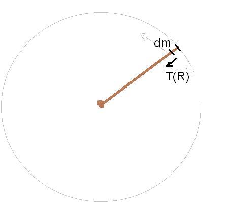

Nope, there is no such boundary condition. However, perhaps I can know something about the tension in the farthest point of the rope? The length is L, so I can write an f=mLw^2 equation there, if only I knew what m to apply. Its not the entire mass of the rope, right?
What forces act to the small piece of rope at the farthest point of the rope? Is it something pulling it outward?
ehild
I think that on the outer point there is only T, the max T, inward. Causing the circular motion.
At the end of the rope, only the inward tension acts on a small piece of the rope. So dmRω2=T(R). dm can be arbitrary small. What about T(R)?
ehild
Well, according to the obtained equation, T(L)=-0.5L^2 * p * w^2 + C.
And as you say, considering the forces, -dmLw^2=T(L). And p is M/L, and dm=p*dL

dm is as small as you like. And T is proportional to dm. At the end of the rope there is only one molecule... Its mass is practically zero compared to the mass of the rope. How big force is needed to keep it circular motion?

I tried to guide you that the tension is zero at the end of the rope. lim(r->L) T(r)=0.
You got correctly in post #12 that
T=-0.5r^2 * p * w^2 + C.
The tension decreases outward.
Now you changed the minus to plus. Why?
If r=L, T=0. What is C then? ehild
