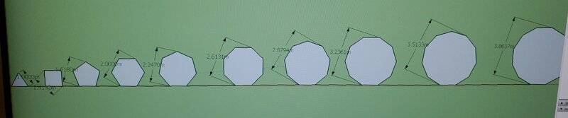

How do I calculate the diameter of regular polygons with 1 as side length?
I measured the maximum diameters of 15 regular polygons with side lengths of one. Is there a way to calculate the maximum diameter for regular polygons of any number of sides without using pi or any nonterminating numbers?
03-Sided = 1
04-Sided = 1.4142
05-Sided = 1.6180
06-Sided = 2
07-Sided = 2.2470
08-Sided = 2.6131
09-Sided = 2.8794
10-Sided = 3.2361
11-Sided = 3.5133
12-Sided = 3.8637
13-Sided = 4.1484
14-Sided = 4.4940
15-Sided = 4.7834
  • Row of regular polygons drawn side by side on a green background, with sides increasing from a triangle to a 13-sided polygon, each with a diagonal measurement label printed beside it.
Yes, you could derive a formula.
Consider the regular polygon inscribed in a circle. Lines drawn from the circle's center to each vertice of the polygon are radii. An 8-sided polygon makes 8 wedge-shaped isosceles triangles, so you can determine the angle between the radii as ##2\pi/8##.
Knowing the length of the n-gon side, you can determine the radius using the sin() and noting that you can drop a perpendicular line splitting the isosceles triangle into two right triangles so the angle is ##1/2 (2\pi/n)##
and the ##sin(\pi/n) = (1/2 side)/radius## since you know the side length solve for the radius.
Or you could use this handy online calculator:
https://calcresource.com/geom-ngon.html
