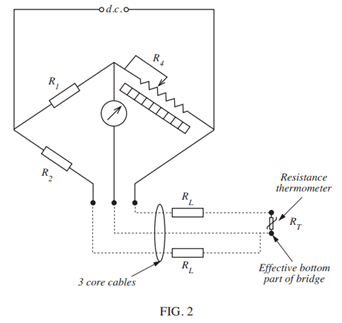

a. The resistance thermometer bridge circuit shown in FIGURE 1 has a designed maximum temperature of 200°C, ignoring the effects of connecting wire resistance. If the connecting loop is 250 m determine the smallest gauge (swg) of copper wire which must be used if the indicated maximum temperature is to be less than 202°C.
The temperature coefficient of resistance of the thermometer is 0.0042 °C–1 and the resistance of the thermometer is 112 Ω at 20°C. Assume the connecting leads are at 20°C.
b. Using the gauge of copper wire calculated in part (a), calculate the maximum indicated temperature using a 3-wire system (as shown in FIGURE 2) over a distance of 125 m.

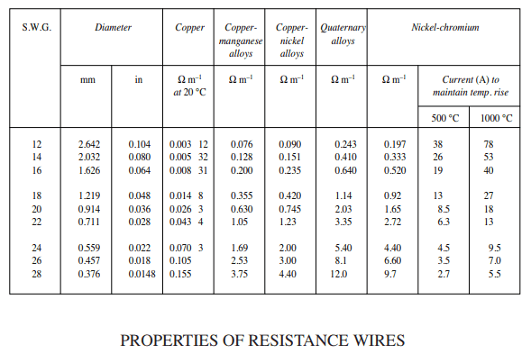

Hi All,
Really struggling to get my head around what I'm doing wrong - every time my answer of wire diameter comes out too small for what's included in the table of SWG. I must be doing something wrong somewhere - my attempt is below.
Any help is very much appreciated.
243455
1 m = 103 mm
1 m2 = 106 mm2
4.22 x 10-8 m2 = ? mm2

Ah ok, but 4.22 x10^-8 m^2 = 0.0422 mm^2 however I cannot see this value of diameter in the SWG table provided - do you think it would be easier to calculate the ohm/m for copper instead or is there another error in my method?

2. Can you explain how you think this bridge circuit is supposed to work? Specifically, how does this "fundamental interval" enter the picture?
Ok, well I believe the bridge is designed to be balanced so that the value of resistance, RS, can be calculated and thus related to the resistance (ant therefore temperature) of the thermometer. It is this value I have used to incorporate into my rearranged resistivity equation to determine the wire diameter. Am I right to use the fundamental interval of the thermometer to calculate the wire size of the connecting loop?

First, you misunderstood the table. The numbers have units of Ohm/m. These are not resistivities but resistances per unit length for a given gauge. The dimensions of resistivity are Resistance times Length.
