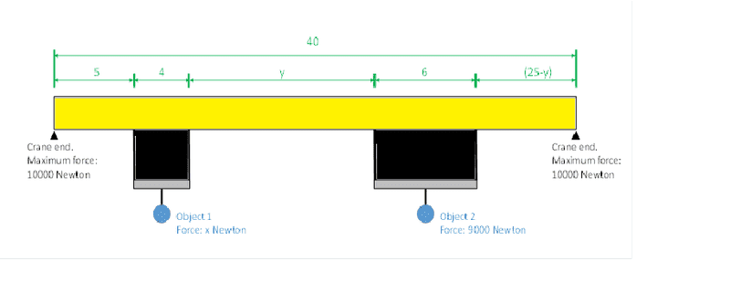

Hi,
I am busy now for a couple of days with a physics problem. I am not really into physics, so I hope you can help me out. Its about the maximum force of an object (object 1 in this case). I included an illustration.
* The left and right pivot have an max of ten thousand N (upwards);
* The force of the second object is nine thousand N (downwards);
* The force of the first object is unknown (downwards)
Furthermore:
* Distances in meters are given, but ‘y’ is unknown;
* Also the first object has an fixed position, while the second can be moved, but has to be rightsided and within 20m of object one.
I am looking for the maximum force x in N of object 1.
Diagram of a yellow beam 40 m long with supports at both ends labelled Crane end, maximum force 10000 Newton. Object 1 with force x Newton hangs at 9 m from the left end and object 2 with force 9000 Newton hangs at the position marked y plus 4 from the left end; distances 5, 4, y, 6 and (25-y) are marked along the top.
I studied some basics physics about ‘moments’ and know that clockwise = anticlockwise. From that perspective I first thought that maybe the simple solution was that the max of x is the maximum of the left and right pivot – the force of object 2, so 11 thousand N.
But that’s maybe too simple. So, I did some additional calculations, where I included the widths and distances into the calculations, and my final answer was that x=9000 and y=2. But, the more I think about this, how more I become confused.
Could someone help me out on this ‘puzzle’ and explain what the maximum of x is, and more importantly, why?

please show the details of your attempt using the distances.
Which point did you take as your axis? What moment did you calculate for each force about that axis?
