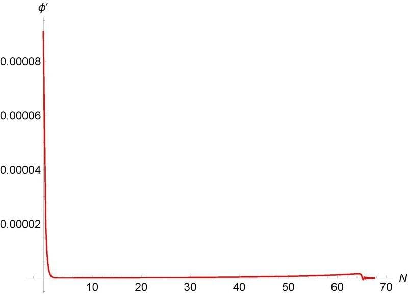

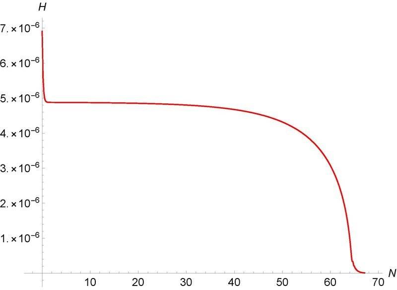

Thanks for that resource! And you published a paper with Kinney, I've followed some of his notes on inflation. I have solved the dynamical equations of inflation (KG equation, Friedmann equations, etc) simultaneously in Mathematica but in the context of warm inflation, then plot out say, ##\phi##, ##\dot\phi##, ##H##, etc. So I think I'd just use the lowest order in slow roll approximation for ##P_S## and ##P_T##, I think solving it from full numerical calculation would be hard for me now (just starting in this field). But at what point in the plot of say ##\dot\phi## vs ##N## should I choose ##\dot\phi_*## to plug into ##P_S##? I think ##H## is not a problem since it looks approximately constant so I can just measure the value of ##H## anywhere in the plot and set it as ##H_*##.
We say that we countdown the number of e-foldings (N=60, 59, 58, ..., 0) from the start of slow-roll inflation and when we say that we calculate a quantity at the horizon crossing we mean say at N=60 (start of slow roll inflation, while in the plot it is N=0) so does that mean ##\dot\phi_*## is the initial condition itself?
Which N you choose depends on what length scale you wish to measure r on. The mapping between and N and k is model dependent, but for a given model, once you pick the physical length scale of interest (the scale [itex]k = 0.002 h^{-1}{\rm Mpc}[/itex] was a standard one back in the day, as was [itex]k = 0.05 h^{-1}{\rm Mpc}[/itex]), you can determine the corresponding N. Do you know how to map k to N?

It is N, it starts from N=0, 1, ..., 60. Should I set N= -60, -59, -58,... ,0? I don't know yet the relationship between k and N.
You can find the relationship by taking the derivative of k = aH wrt N...

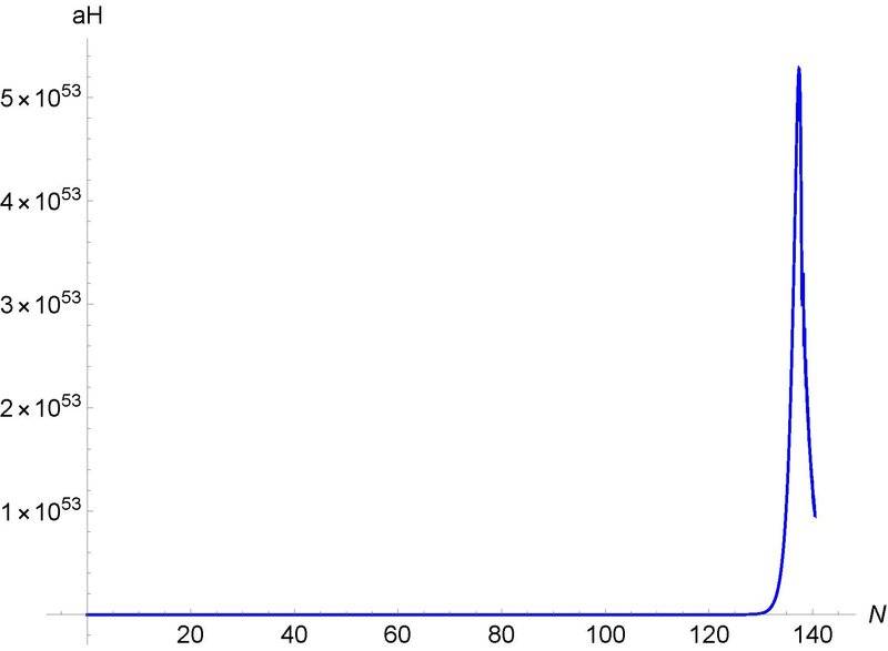

Oh, that is very informative. Last question though, I have set my equations to be the KG equation, Friedmann equation, and the number of e-folding equation (##N=\int Hdt## or ##\frac{dN}{dt} = H##). So I don't have any equation involving the scale factor ##a## that I need to plot ##aH##. So Suppose I use the acceleration equation ##\frac{\ddot a}{a} = \frac{1}{3M_p^2} (V-\dot\phi^2)##, I would need two initial conditions ##a(0)## and ##\dot a(0)##, what do you think I should set for those two? As I remember ##a(0)## is usually set as 1? I'm not sure.
But you do have an equation for the scale factor! Can you write ##a## as a function of ##N##?
Oh, I'm sorry. I could write,
(1) ##\ddot \phi + 3H (1+Q) \dot\phi + V_{,\phi} = 0 \quad ## KG equation
(2) ##H = \frac{\dot a}{a} = \Bigg(\frac{1}{3 M_p^2} ( \frac{1}{2}\dot\phi^2 + V + \rho_r) \Bigg)^\frac{1}{2} \quad## Friedmann equation
(3) ##\frac{dN}{dt} = \frac{\dot a}{a} \quad## Number of e-folding
But due to (2) and (3) being equal, I can only explicitly use either (1) (2) or (1) (3), in my case I choose the latter so that I can also use ##N## for plotting. So how would I specify the initial conditions for ##a(0)##? Since before, I'm using ##H## instead so I just specify ##H(0) ∝ \phi(0), \dot \phi(0)##
Pick whatever you want for a(0): it's the proportionate change in ##a## that matters. Also, you've got a misplaced power of 2 in (2) (should be ##H^2##)
