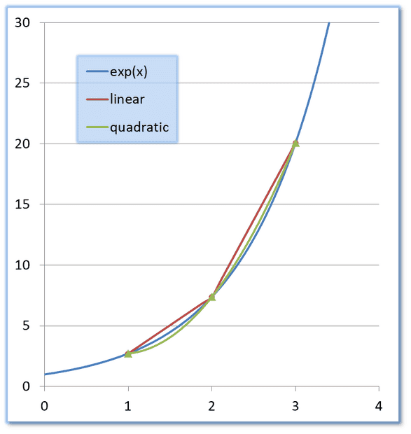

Sorry, the question is not in English so I translated it. It is supposed to say "error". It is also given that ##p_1## and ##p_2## are based on the same data points. Though I assume this means that ##p_2## are based on 3 datapoints since it is a 2nd degree polynomial and ##p_1## are based on 2 of those datapoints.
If ##p_2(a)=0##, then we do have a problem indeed as division by zero makes the quotient go to infinity. Actually I am not sure how that would be handled? I have been confused by taht in the past and never sorted it out.
bremenfallturm said:
It is also given that p1 and p2 are based on the same data points. Though I assume this means that p2 are based on 3 datapoints since it is a 2nd degree polynomial and p1 are based on 2 of those datapoints.
Possible: yes. Fair ? Hmmm... piecewise linear would be fairer
Suppose you have three points (I took ##e^x\ ##, x = 1, 2, 3) then a first attempt would be something like

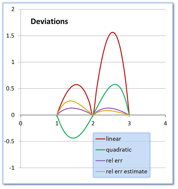

with deviations from ##e^x## as follows:
So red is the absolute error for the linear interpolation.
| red minus green | would be the error estimate for the absolute error.
And yellowish is that divided by ##p_2## (The estimate for the relative error. No worry about 1/0)
The purple line is the actual relative error (i.e. |(red - ##e^x##)| / ##e^x##)
Draw your own conclusions ...
