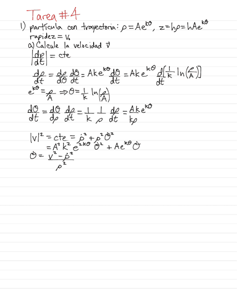

A particle moves with constant velocity along the curve r = e^(θ) and z = r (cylindrical coordinates). The speed, v, is constant.
a) Calculate the velocity and acceleration of the particle in terms of θ and v.
b) Show that the velocity and acceleration are perpendicular.
c) Find the expression for θ(t).
v[/B] = dr/dt (radial direction) + r dθ/dt (tangential direction)
v^2 = (dr/dt)^2 + r^2 (dθ/dt)^2 = constant
dr/dt = dr/dθ dθ/dt
TheLil'Turkey said:
v = dr/dt (radial direction) + r dθ/dt (tangential direction)
That's for 2 dimensions. This is moving in three.
Posting your algebra as an image makes it hard to refer to specific equations in comments.
Expressing dr/dt in terms of dθ/dt, then expressing that in terms of dr/dt is going round in circles. Get all the velocity components expressed in terms of the time derivative of one of the coordinates - r, θ, or z, whichever is easiest - as you eventually did.
