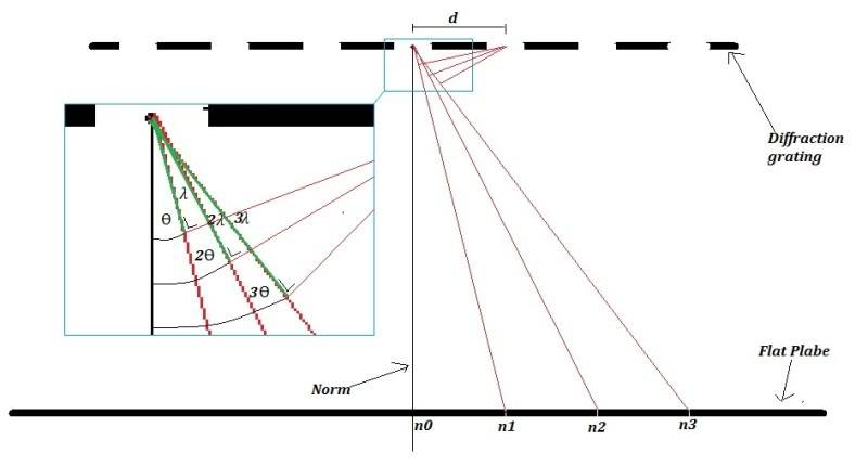

Hi, I'm doing a experiment/report on this topic, I'm trying to get a better understanding of the equation "nλ = dsinθ"
ALL length measurements are in meters for simplicity's sake.
n = bright spot number from the central bright spot (n0)
d = distance between slits
The angle "θ" and distance between slits "d" are known in this experiment.
I drew a diagram to represent how "I think" it works! basically what would happen when monochromatic light would do as it passes through diffraction grating!
The image is zoomed in very close!
I know that this equation is derived from trigonometry, but I be correct in what I am saying in the diagram?
Diagram of a diffraction grating with slits spaced d apart, light rays bending to bright spots n0, n1, n2 and n3 on a flat plate, with an inset showing path differences of λ, 2λ and 3λ at angle θ.

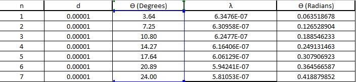

Another question I have:
Is the "nλ = dsinθ" flawed? what I noticed was, if you look at the results below, the wavelength seems to be inverse proportional to "n"...is this possibly slight errors I did during the experiment? or is it because the further the waves spread the less wave length it will have?
Table of diffraction results with columns n, d, Θ in degrees, λ and Θ in radians, for n = 1 to 7 with d = 0.00001 m and λ falling from 6.3476E-07 to 5.81053E-07.
Sorry if this seems silly, I've been trying to crack it for hours...if someone can advise me I would be grateful, but please keep your answer dumbed down as much as possible for me to understand!:P
How did you get the theta values? How far was the screen from the grating? What were the distances of the bright spots from the central ones?

I see how you got the data for the first spot but what about the others?
If xn is the distance of the n-th spot from the centre, the n-th theta is θn = tan-1(xn/D).
The spots are not quite equidistant.
ehild
So you're saying...that the distance between "n0" and "n1" is not the quite equal to the distance between "n1" and "n2"?:bugeye:
So basically the distances between each bright spot are not exactly equal?
Would this explain why the wavelength is slowly declining in length as you go up in "n" in the table I put up?

You should have read the positions of all spots on the metre stick. From all x values, you would get a theta and a lambda. And those lambda values would scatter around the real one.
