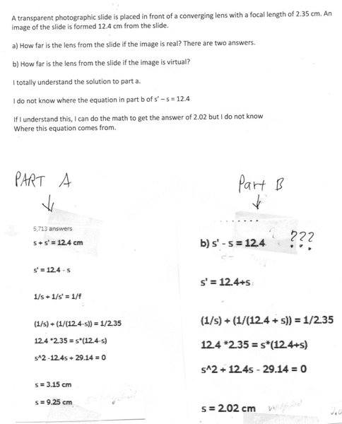

See my attached information
On my attached solution
see my attached sheet
Please see my attached write up.
I would appreciate a quick nudge as stated.

Make a picture. Note that the virtual image is on the same side of the lens as the object. And the image distance has to be taken negative, if it is virtual image.
