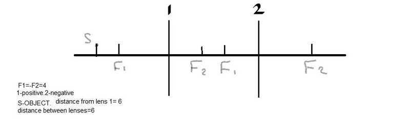

S is a lighted object, height=1.
what is the final image that is created by the system?
i just don't understand how do i find the location of a virtual image created by a negative lens when the rays converge to a point beyond its focal point

Why can't you just use the thin lens formula?
you mean this?:
1/f=1/U+1/V
i used this for the lens 1, and found that V, image distance, is 12, which means it is located 6 to the negative's right, 2 after the focal point.
So how can i use the equation for the second lens? U is supposed to be an object, not converging rays.
mrlevis said:
you mean this?:
1/f=1/U+1/V
All good.
The image from the first lens becomes the object for the second. But since it's past the second lens, it must be treated as a virtual object. Just use the usual sign convention: If an object before the lens has a positive object distance, one after the lens would have a negative object distance.
oh... you right.
i don't know, for some reason i didnt think it would work.
but can you explain why is that? is there a simple proof to it?
I suggest that you review the derivation of the thin lens formula.
ok, thanks for help
