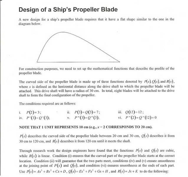

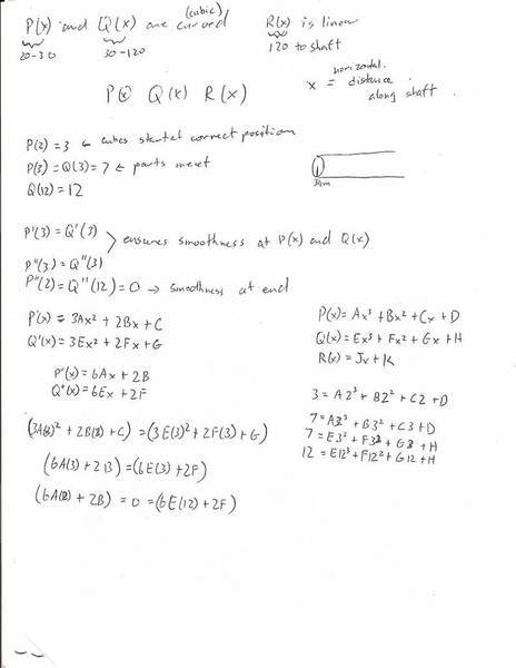

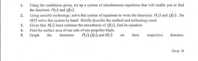

Here's the problem, attached to the post. I've tried using matrices to solve it but I'm not sure if the answers I am getting are correct. The professor hinted that the answers should be whole numbers, but I keep getting decimals. Any help??
I've uploaded a scan of my work, scan02 is where I plugged in for the X's and found the derivatives. I then put them into a matrix.

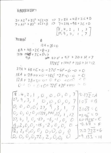

Sorry, I have to reply in order to attach my matrix working. The limit is three files. Anyhoo, :smile: my work isn't exactly the "prettiest" but at least I hope it's clean enough for a Helper to show me where I went wrong. It also shows the answers I got for each variable, (A, B, C, D,..etc.)
Thanks again!
