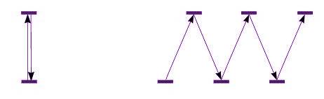

Hi all,
a maybe silly question: In the SRT-experiment with the lightwatch (which is taken to show the time dilation for a moving clock), why does the light follow the clock? Light is indepedent of the emitting source. So I would expect that the clock is moving away and the light is moving straight away and could never hit the mirror (because it was moved away).
An example for that experiment is shown in http://www.einstein-online.info/vertiefung/LichtuhrZeitdilatation@set_language=de.html
(sorry, a German site)
Best regards
Martin
If the light hits the mirror in the rest frame of the clock, then it must hit the mirror in every other frame.
Welcome to PF.
The speed of light is independent of its source, true, but the direction it travels isn't. If that weren't the case, you'd end up with inconsistent results where using different frames (one where the source is moving and one where it isn't) disagree about whether a light pulse strikes a target, like the mirror.

I think the simple answer is that this is just an illustration to help you visualise what is occurring, i.e that the light takes a longer path when the clock is moving before it hits the other plate than if it was stationary. i.e it appears to have slowed down.
It may make more sense if you think about the path the light is taking through space. Imagine that the light clock is moving through a cloud of dust. As the flash of light bounces back and forth between the mirrors, it will momentarily illuminate the dust particles.
Someone at rest relative to the clock will say that light is bouncing straight up and down; someone at rest relative to the dust will say that the light is following a zigzag path through space. But - crucially - the same dust particles are illuminated by the beam in both descriptions. That is, the path of the light is the same in both descriptions, no matter what the mirrors are doing.
If the dust particles are photosensitive (little grains of silver nitrate?) they will be permanently changed by exposure to light, and we can use this to determine the path of the light after the experiment is done. In both descriptions these light-affected particles will form a zigzag line through the cloud. Someone at rest relative to the clock wil say that the zigzag line is because the dust particles were moving sideways while the light moved straight up and down; someone at rest relative to the dust will say that the zigzag line is because the dust was not moving while the light was moving sideways as well as up and down. These apparently contradictory explanations are actually just two different ways of saying the same thing: the clock is moving relative to the dust.

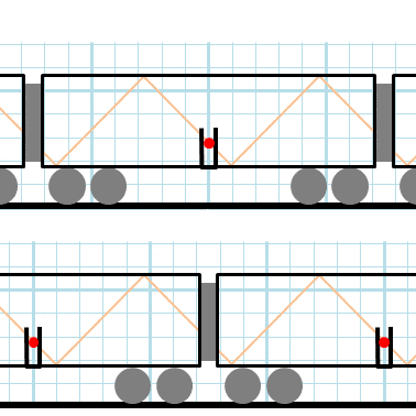

Maybe this animation from an old post of mine will help
Dr Greg said:
Maybe this diagram helps
Here's something (it could be a pulse of light, it could be a ball) bouncing up and down in a train.
An observer in the train (top) infers the thing is moving vertically up and down.
An observer on the ground (bottom) infers the thing is "sliding sideways" in a zig-zag path.
This is valid in both relativistic and Newtonian mechanics.
Source: https://www.physicsforums.com/threads/how-does-light-slide-sideways.804112/post-5048516
