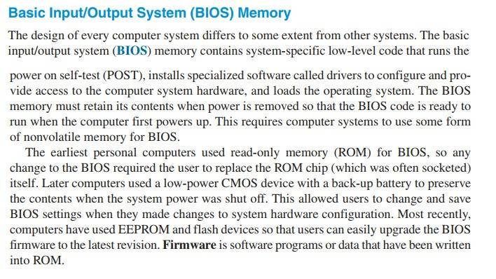

I have boldfaced the important sections in the quotes above.
It looks like in case of battery failure in a CMOS BIOS, the settings could be restored with some extra work on the part of a user. It implies that there was some kind of an additional nonvolatile memory which came into the action after the computer power-on even before the BIOS itself. Actually, such a nonvolatile memory would be a precursor to BIOS memory.
The attached text could be helpful. Thank you for your help and time.

PainterGuy said:
BIOS memory.
There are actually two parts to what you would call the BIOS memory. There is the non-volatile part that stores the initial boot code and there is the battery backed SRAM part that stores configuration.
The bios will load a default set of configuration on startup if there is no battery backup available. This almost always does not require user intervention.
Some systems will need to be configured before they will work properly. This is not the case with most systems assembled in the last nearly two decades or so. The default settings on most newer systems will work fine and the BIOS will be able to auto-configure the hard drives.
Older systems will have no boot devices configured as default so those will need to be entered. Other configuration will need to be changed for non-default usage. The defaults for older systems for a long time were to be as compatible as possible for the default settings. This required the devices to be set to the enhanced type or usually there was an "Optimal" setting that would changed all devices to be the enhanced mode.
It is rather odd that we still use SRAM to store settings that are often only changed once when a system is built. This was done originally since non-volatile EPROMS required a treatment with UV light to be rewritten. Since the technology has been commonly available for something like 40 years the battery should only need to run the clock.
