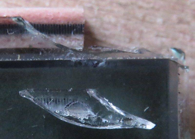

I have a small LCD clock and a corner of the LCD glass cracked and separated. This small region of the glass lines up with one of the pads on the circuit board and the result is that one of the segments is non-operative. I look at the LCD glass and I can't see any sort of circuit trace. Is the conductive part of the glass LCD element transparent? I don't have a good picture of how this connection works.
More to the point, is there any hope of bridging the gap created by the cracked corner of the glass? Could I put a little solder blob there or something like that?
Or should I just buy another cheap clock? :-)

It's hard to answer without seeing the real thing. My guess is that the electrical connection is a bit of metalization deposited on the glass, perhaps at the edge between layers. Just because you can't see it easily doesn't mean that there isn't some sort of conductive coating there.
The questions "How does it work?" or "How is it made?" are quite different from "How should I repair it?" or "Should I repair it?". It will be difficult to achieve a lasting repair that is worth the effort for this type of component. It is the nature of our high tech world that many products can only be built to perform well, with high reliability, long life, and at low cost in factories with significant engineering involved. Typically, this works against repairability.
If you do want to attempt a repair, I would suggest a bit of conductive epoxy (like what they sell to repair rear window defrosters in cars, for example). You can try to paint this over the area that was cracked to bridge that gap. The problem is that this may be an internal layer.

Thank you. I can provide a photo, and I will if you like, but I suspect it wouldn't help much. Of course there's something conductive there that I can't see. There has to be. I was hoping to figure out a bit more about this invisible conductive trace so that if I attempted a repair I would have something, even if invisible, to kind of aim for.
I did google to try and find out about LCD construction but I didn't find what I wanted. If I had I succeeded I wouldn't be bothering you guys. Getting answers on web forums is less reliable than google. But it does work really well sometimes.
Conductive epoxy seems like a good suggestion. Thanks. I'll look into that.
Of course I should just buy a new one. Duh. A tube of epoxy probably costs more a replacement. That's not the point.

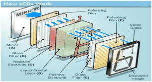

Typical LCD sandwich
Note that the segments are also a transparent thin film ITO.

Postscript: I fixed the thing.
It sat on the shelf for a while. Then I thought that rather than buy conductive epoxy I'd make some. I didn't have any silver sitting around, not that I could think of anyway. Nor graphite power. Pencil leads seemed to be poor conductors. So I sanded down a piece of 14 gauge copper wire and added the particles to some two-part epoxy.
When it dried my ohmmeter indicated no conductance. Huh. I was kind of wondering how a suspension of conductive particles in an insulating epoxy was supposed to end up as a conductor.
I broke down and spent the $12 on the rear window defogger repair kit that has conductive epoxy. I glued the piece of glass back onto the LCD and also left a little to dry on a piece of cardboard. Later I tested the sample on the cardboard and again, no conductance. WTF?
So I just put the clock back together and the missing segment was lighting up! I guess my ohmmeter test was faulty somehow. Maybe my homemade epoxy actually was conductive? The problem was that a different segment was now missing and with some digits the whole screen went blank.
I guessed I was too sloppy with the epoxy and shorted out a neighboring column in the matrix. So I scraped off as much epoxy as I could and rebroke the glass. I tested it like that, with the missing piece of glass removed, just to see that I was back where I'd started with the one missing segment. Instead I found, much to my surprise, that it worked perfectly! I must have fixed the short but left just enough epoxy to connect the previously missing trace.
So now I have my 25 year old $8 clock working again. It only cost me $12 and a few hours of fiddling. It's very silly, I know, but it feels good.
