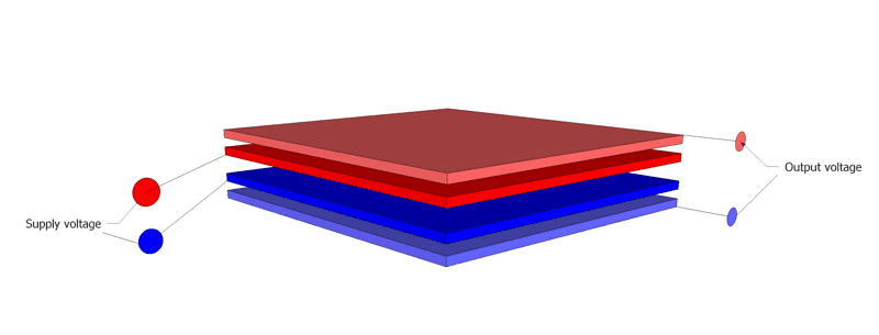

Made a rough drawing of the principle. However it does not seem that Windows 7 is capable of doing the simple trick to make file transfer into an FTP site possible (Easy on XP, but in 7, no). It is not possible to upload pictures directly to this forum so I must try to describe the basic principle.
Imagine 4 conductive plates oriented in parallell with a small space between them. Supply voltage to the two inner plates, and wait till they are fully charged, and keep the voltage supply connected. Now measure the voltage over the two outer plates that has no physical contact to the inner plates. Will there be any measurable voltage over the two outer plates?

"Attachment" ofcourse - not "Insert image". Thanks! Here it is.
The lighter blue and red are the "output" negative and positive charge.

As the two extra plates are insulated, there can be no change in the charge on them. They will polarise by induction and the fields around the capacitor will change. But I can't think of any reason for any change of potential
If the plates are insulated and all distances are small compared to the plate sizes, roughly the voltage you applied to the inner foils.
As soon as you connect anything conducting (like most voltmeters), the voltage will drop quickly.@sophiecentaur: A potential change does not need a changed charge. You can draw the system as 3 capacitors in series, where the middle one (going from the outer side of one plate to the outer side of the others) is tiny compared to the other capacitors. This tiny capacitance will get nearly the full voltage.

Not really. Just whatever charge was capacitively coupled from the inner plates when the voltage was applied. And no more will appear when you drain them. (except you will capacitively drain a little from the first two plates). No additional energy will ever be transferred into the outer plates from the inner plates unless the inner plate voltage is changed. You will be able to pick up more energy on the outer plates from your local radio station than from the inner plates.
