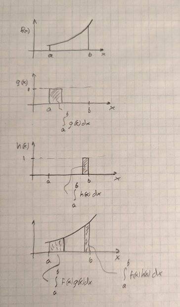

Given that $$\int_a^b f(x)g(x) \, dx = \int_a^b f(x)h(x) \, dx$$ and $$f(x)=e^x$$, is it true that $$\int_a^b g(x) \, dx = \int_a^b h(x) \, dx$$?
Does the first equation hold for any ##a## and ##b## or for are ##a## and ##b## fixed?
##a## and ##b## are fixed scalar values
Then my answer is, no, not necessarily. ##g(x)## and ##h(x)## can "cut out" different sections of the ##f(x)##.

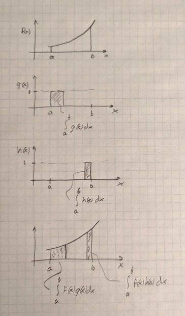

For your consideration... the laziest, least rigorous, counter example; graphic novel style.
Thank you
Thank you! one counter example must be enough
