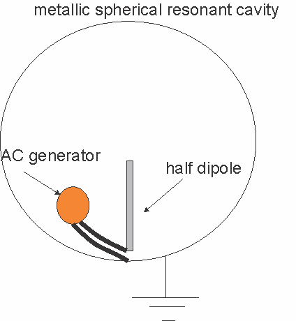

Hi ,
what happen if a half dipole linear antenna is placed inside an electric conducting resonant cavity? The cavity itself is the conductive ground of the half dipole antenna. How can I solve such problem in which the cavity works as resonant cavity and it is part of the antenna itself?

Can you post a sketch of the antenna inside of the resonant cavity? Given the antenna pattern of a monopole antenna, I'm having trouble visualizing a resonant cavity shape that would work.
And why use a monopole antenna instead of a full dipole antenna if you want to make this work inside a resonant cavity?
the system looks like this
massi
massi
That only looks like it would be "resonant" in some very complex modes. What is the overall goal with this? Is it just an exercise in simulation for school, or does it have some practical application?

Your sketch shows the reflecting cavity in the near field. That also will make the calculations/simulations more complex. Is that your intent?
yes it is that
