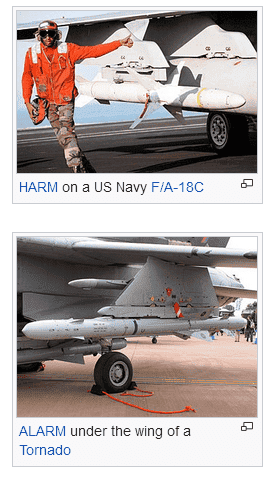

You need to be a bit careful just blasting out radar interference...
https://en.wikipedia.org/wiki/Anti-radiation_missile
:wink:
