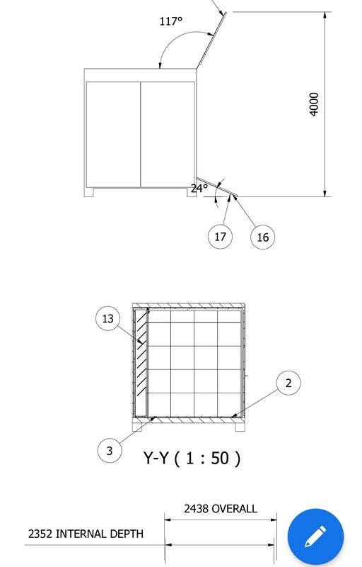

Hi all,
My name is Yashi. I am assigned to design a mechanical lifting device to lift a overhead extension cover weighing nearly a tonne. There is no power allowed as its deployable 20 ft. container. Extension is 5.6m wide by 1.5 m. Is there any pulley n winch mechanism to aid ? Any ideas ? See photo attached from supplier drawing. On right elevation, the sheet has to be cut n flap to be lifted at 117 to horizontal. When it is down, it shud be inside the width 2438mm.Feel free to ask queries.
I thought of using hydraulic Ram n actuators but was informed no power available on some site. I am thinking if we can use pulley mechanism from back that connects to top of overhead. I hv modified the container n attached screenshot of how it has to be. Please help if you know of a way to lift this. When this go down, it shud be flush with vertical or inside it, in case we use folding doors in front.

  • Technical drawing of a container with a hinged top panel angled at 117 degrees, a 4000 dimension to the right, a 24 degree lower flap labelled 16 and 17, and a Y-Y section at 1:50 showing a 2438 overall width and 2352 internal depth.

I am confused by the poorly specified problem. Can you provide a 3D sketch of the deployed extension cover.
Can the cover be detached completely from the container? Is the cover stored inside or outside the container when not deployed. What else is then also inside the container.
A cover that weighs close to one tonne is not there to keep the sun or rain off the area next to the container. Why is it so heavy? What forces must it oppose as a cover, and how is it held in position when subjected to those forces and it's mass.

Hi Thank you for reply and queriy. Its not school work but real life project. No power is allowed as its movable unit and there is no provision to put them in place. It will be used at remote sites where there may not be any power outlet. There will be atleast 2 people to operate. Overhead extension will be hinged on indoors so when overhead is relaxed, it sits parellel to front vertical surface. So we need to lift it from vertical position to shown angle which comes to 143 deg movement and stay there. It has to sit 4m above ground approx.

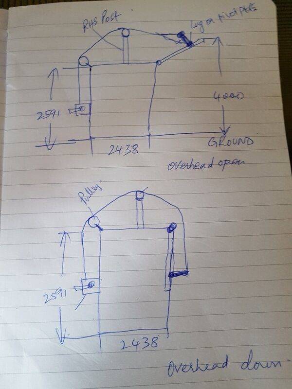

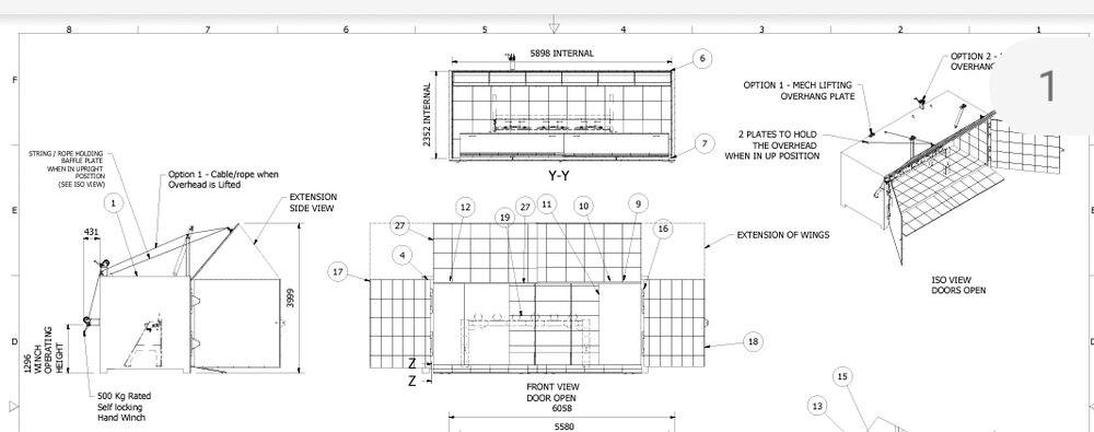

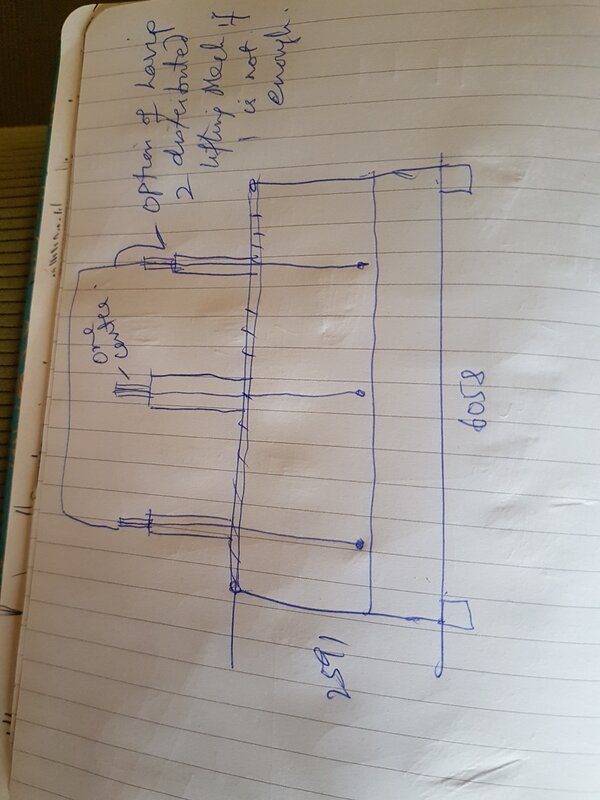

Hi All,
Thank you for response. I have drawn sketch to give you an idea of what i think should be good. Let me know your thoughts.
To answer some of queries. Its heavy because its made of 6mm bisalloy and padded with 25mm ballistic rubber. Force won't be applied directly on surface but to protect the bounce after hitting at object.
See the sketch and let me know if it will work or any other option. If it does, i will need to determine loading and material. Content inside the box or container is steel plates and bullet catcher but low level ammunition. Max. Force applied is just 70N. Overhead is only for catching anything out of bounce after hitting plate.
Thanks in advance.
Yashi

Hi Baluncore,
No the overhead can't be detached as it acts as door when it is lowered down or in relaxed position as it rests against front surface as drawn.

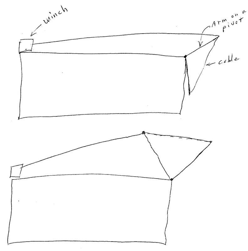

Here's another idea for lifting the door. Fasten a winch to the top rear of the container. Run the winch cable to a pivoting arm with the pivot near the door hinge. Then another cable from the pivot arm to the door.
Two hand-drawn sketches of a box-shaped container with a winch on its top rear corner, a cable running to a pivoting arm near the hinge, and a second cable from the arm to a door that is shown lifted in the lower sketch.
The winch must be rated for lifting. Here is a US source for winches: https://www.mcmaster.com/winches/winches-for-lifting/. If you are in a country not served by McMaster-Carr, their catalog gives you some ideas on what is available.

Yashi,
Being so heavy, I would start by verifying that the extended overhead can keep its shape, as well as the rolling stability of the container, when fully lifted.
The of the overhead edge may tend to bend and deform by areas not supported by the lifting mechanism.
The hinges may need reinforcing as well, in order to resist high forces that may develop at certain angles and induced by the lifting mechanism.
Consider that any external mechanism will be exposed to heat and rain and corrosion.
You could also estimate the time required to complete the work of lifting that heavy door and overcome friction of the mechanism by the muscular power of one man.
Then decide how many persons you will need actioning that mechanism.

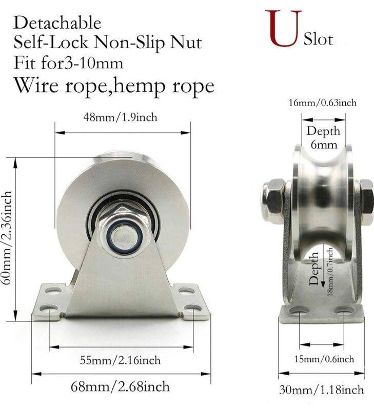

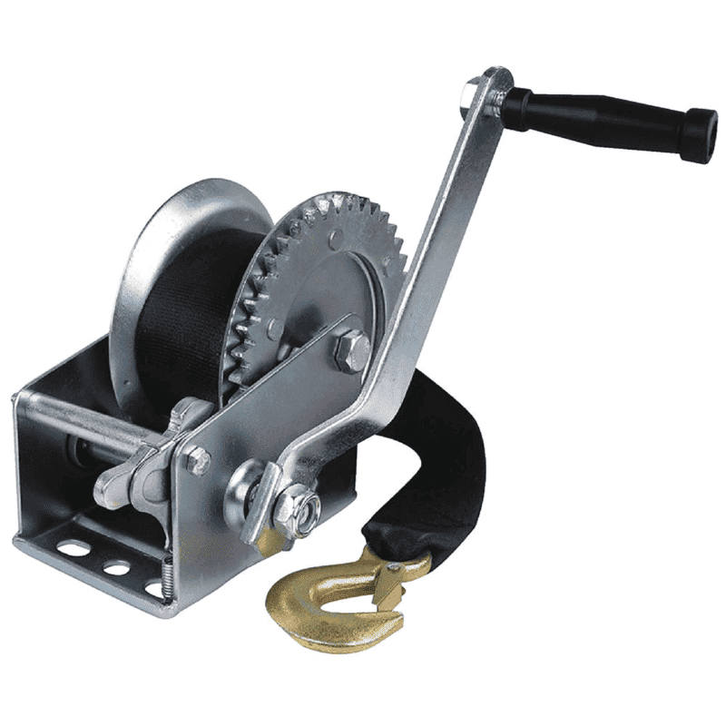

Hi Thank you for insight both of you. I have done bit of search online. I found following winch and pulleys. I learned about Mechanical advantage of pulleys so more the pulleys weight bearing capacity on winch is that much less. So for using 2 pulleys, 800 kg will result in just 200 kg. Is that correct ? Is it possible to show the force and load on the pulley and winch using my design and the one jrmichler suggested ?
I mean how can i prove mathematically that winch will hold it. I m planning to use 2 set of winches, 1 at each end to uniformly distribute load...although winch is rated for 700 kg. In short, i want to understand physics behind this mechanism so i can prove it will work. We hv to build prototype first.

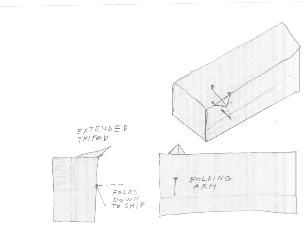

Some alternate ideas:

Hi Lnewqban,
Thank you for valuable advise and youtube links. Let's call top plate as overhead extension. How about i split the plate into 2 halves, that way weight of plates will be just 350 kg each n i can use 500 kg rating winch x 2. There won't be any issues with bending or coordination of 2 winches an issue ?
As per information attached earlier, rope dia is 5mm max. N its 22m cable length while i hv to play with max. 5.5m.

There are two types of hand powered winches - those rated for lifting, and those not rated for lifting. The difference is that the winches rated for lifting have an automatic brake that locks the winch drum in position when the operator let's go of the handle. Winches not rated for lifting do not have this brake. If the operator let's go of the handle, the load drops while the handle spins around and breaks the operators arm.
A winch not rated for lifting is extremely dangerous for lifting a one tonne lid.

I recommend you postponing the selection of any hand operated winch until you have calculated the forces and displacements of the mechanism you prefer.
Don't assume that the load on your winch will be equal to the weight of the door(s); as stated above, mechanisms often develop higher loads as they adopt different angles.
With some modifications, the motor of each mechanism shown in the videos could be converted to manual operation; I posted those only to give you an idea about other possibilities.
As jrmichler has explained above, a suitable winch for this application should have a ratchet mechanism that automatically locks the load at any point and in any direction (winding and unwinding).
Please, run a wind load calculation and determine the tipping resistance of the box when door/overhang is fully extended, terrain is not flat (has some negative slope) and the highest wind and gust speed rated for your area is blowing perpendicularly to the side of the box that is opposed to the opened door/overhang.
If danger of tip-over exists, you will need to use counterweights or cables anchored to the ground on the opposite side.

There are several safety hazards in this project if not done carefully. Pulling one ton with a hand cranked winch is common. Every boat trailer does that. But using it to lift a heavy object over people's heads is very different.
Hand-cranked drum winch with a black strap wound on the drum, a geared crank handle with black grip, and a brass-coloured safety hook on the strap end.

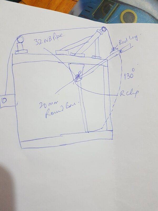

Hi All,
Thank you for valuable advise and tips. So far over 2 days we have come to conclusion, split the overhead extension, use hand brake winch which is self locking so it can hold on its own when released and calculate the wind load. so that makes each overhead to 350 kg and if i use double rated (700kg capacity) hand winch that should sustain load ?
Few more consideration or option as i am told today, Winch is only for lifting and once extension is lifted to desired height or angle, it should stay there and winch has to be removable so to avoid any weather effect and then packed in the container.
If it was flat horizontal, it wouldn't be that issue,but here I need to lift from vertical to horizontal and then raise 53 deg. Now lifting mech has to be removable. Which one is better wire rope or webbing (strap) ?

What fabrication capabilities do you have available (on-site welding, oxy-cut, lathe and mill machining, etc.)?
Steel wire-rope can handle more load but it rusts and needs big bending radii.
Nylon straps can bend much more, but deteriorate with Sun light.
How did we come down from "overhead extension cover weighing nearly a tonne" to 350 Kg x 2?
Same about the angle: from "flap to be lifted at 117 to horizontal" to 143 (vertical plus 53)?

Hi Lnewqban,
117 to horizontal was for dimensioning but 143 is the angle the overhead needs to move or raised from its vertical position. Add them n u get 270 deg which is angle between horizontal n vertical faces.
As far as fab goes, none on site once the container requires transportation, all attachments need to come off. Once it reaches site, you bolt on items so it needs to be detachable. Width and height for transportation is just lil more than size of container. So cannot keep permanent.

3. Attaching the drawing for ref i hv added both options of winch, on the side and on top. I hv added an option of holding the plate using 2 plates n string to hold in upright position. Let me know if this pulley arrangemnt will be enough. Most of examples of pulleys i hv seen is vertical load but this more of horizontal load.
Please answer them as best as you can.
Thanks again and regards,
Yashi
  • Engineering drawing of a fold-up overhang extension with side view, front view with door open, Y-Y section, and isometric view, showing winch and cable lifting options and numbered parts.
Just some ideas to think about.
The drawing shows possible winch mounting on top at the rear edge. Definitely NOT a good idea, you will lose a lot of winch operators falling off the container (or ladder). People just do not have much control or balance when doing heavy labor in motion. Mount the winches for Ground level operation.
I am a little concerned that from a closed position, the cable is pulling almost vertically on the overhead. Hopefully you have calculated the torque applied to the panel over its lifting path, and the cable tension.
A possible solution is replace the vertical post on top of the container with a tripod that projects past the front of the container.
Another idea is have a bar sticking out from the overhead to serve as cable attachment point. The bar could be either bolted on as needed or hinged at its top so it will fold down for shipping. If hinged of course it will need a stop when at 90° from the overhead. You seem to have the start of that idea in your drawing.
I noticed the pole on the top that the cable runs over. A simple post without bracing is likely to bend, especially if the pulley seizes and stops turning. Be sure to brace that post. Perhaps the dotted lines in the drawing are for that purpose, but it is not clear.
You state the winches will be removed after use. What will you do with the cable? If you plan to remove the cable with the winches, how will you access the end that is attached to the overhead?
For weather protection, wire rope (cable) is available Galvanized, and at least in the smaller sizes,with a Nylon jacket (or other jacket).
Yet another possibility is to use winches and cables rated for Marine use, they withstand outdoor use and salt water spray.
If you use two winches on each overhead, size them, and the cable, and the vertical pulley supports, so just one winch can hold the overhead. If or when one winch fails the remaining one can stop an accident. Account for the extra force when one corner of the overhead falls and is stopped by the remaining winch and cable.
The manual brake release on the winches will require a hand to operate. That leaves only one hand on the handle. Account for one-handed winch operation when sizing. (But probably size the handles for 2-handed operation; much easier to operate that way unless there is a large gearing ratio!)
Cheers,
Tom

Yashi234 said:
If possible could you do hand sketch of other options i got the idea but will be gud to see them.
And one more comment: The pulleys should capture the cable so when the cable is slack it does not completely fall off!
Pencil sketch of a rectangular box-shaped unit with three small pulley wheels on its top face, shown beside a side view labelled EXTENDED TRIPOD with a note FOLDS DOWN TO SHIP, and a front view labelled FOLDING ARM.
Cheers,
Tom

Hi Tom,
Thank u for sketch.
You mentioned calculating torque of lifting plate. Wat are info required to work torque in this case ? Is there a formulae for an angle ? I hve hinged the overhang plate on a 20mm dia solid bar/rod and plate is welded to 32nb pipe. I would have thought with the winch guiding plate over a hinge, it would come up easily when hook attaches to lug on plate. Solid bar is held by lug plates (n secured by r clip) which is welded.
I hv attached sketch. Lug is close to door n plate stops wen it contacts the front edge of container.
One more thing i wanted to ask is I beam vs RHS for post to mount pulley. I beam has more strength compared to RHS ?
Regards,
Yashi
  • Hand-drawn sketch in blue pen of a container with a hinged overhang plate, a 32 NB pipe, a 20 mm round bar pivot, a rod end lug, an R clip, a pulley on a post, and a 130 degree angle marked.
  • Hand-drawn sketch in blue pen of a container front with two doors shown in closed position, with a hinged overhang plate and labels reading "Visible rollers" and "Legs hidden".
