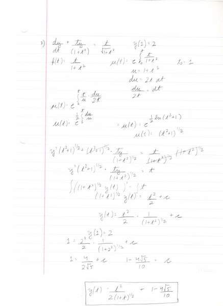

1. Homework Statement
dy/dt + ty/(1+t^2) = t/(1+t^2)^1/2 y(1) = 2
Need to solve this initial value problem. The equation is a 1st order ODE
2. Homework Equations
3. The Attempt at a Solution
I've attached my solution to the problem. Just wondering if anyone can check my work. I solved the problem using the Integrating factor method u(t).
Thank You!
Your attachment is still pending approval as I write this.
Another approach is to multiply both sides by (1+t^2)^1/2 and observe that the LHS is the derivative, with respect to t, of a product. The integration becomes straight forward.
