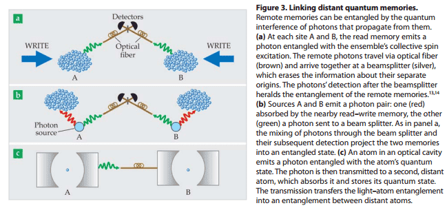

You might get the occasional pair if you use a properly tuned laser. You will mostly get a lot of "noise" - which is common for many setups. So you use filters and coincidence counting to produce an entangled stream. Realistically you aren't going to get much from this configuration. The method you referenced, in its best setup, is not much used anymore due to better (more efficient) methods being available. So anything less than that would not be practical.
BTW, you might be interested in this article about entanglement using a beam splitter.
http://arxiv.org/abs/1602.01907
Note that entangled photon pairs are not produced by the beam splitter, but there is path entanglement. Since you are inquiring about different forms of entanglement, you might pick up something from their description of the setup.

I know they aren't produced by the beam splitter, but as this shows http://www.unige.ch/gap/quantum/_media/publications:bib:afzelius2015a.pdf, the beamsplitter erases the information about their separate origins

Hey Dr Chinese, you said the beam splitter creates path entanglement in this quote, then you contradicted yourself today by saying it doesnt. How's that?
Because I keep telling you: the devil is in the details. Each context is different. You obviously have the interest. Why don't you take the time to read and understand the *entire* article? You can't make blanket statements and expect them to make sense without that understanding. Almost any such statement is easily contradicted in the complex world of Quantum Mechanics.
