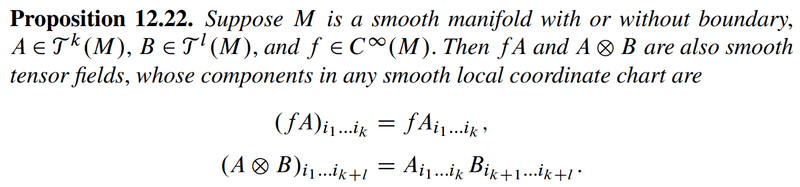

Now, to full understand why Tensors must have this rule is a bit hard to see. It's Proposition 12.22 in Lee's Smooth Manifold book, but I don't have a good geometric interpretation of why this must be so.

Here's that proposition from John M. Lee, Introduction to Smooth Manifolds, 2nd ed., pg. 318:
Proposition 12.22 from a differential geometry text: if M is a smooth manifold, A is a smooth (k,0) tensor field, B is an (l,0) tensor field and f is a smooth function, then fA and A ⊗ B are smooth tensor fields, with components (fA) i1...ik = f A i1...ik and (A ⊗ B) i1...ik+l = A i1...ik B ik+1...ik+l.
This book is a graduate math text, and I'm admittedly a physicist and not a mathematician, but to my reading, 12.22 simply states that the product of a scalar field and a tensor field is itself a tensor, as is the product of two tensor fields. That is, it's the proposition that products of tensors are necessarily tensorial. It says nothing about the covariant derivative. (Indeed, per its index, the book never discusses or even introduces covariant differentiation anywhere in its 708 pages!) So I don't see how this proposition supports the notion that the covariant derivative ##\nabla## is nontensorial in its transformation properties. Instead, ##\nabla## is to be regarded, not as a tensor field, but as a tensor differential operator. It is tensorial because its operation on a rank ##

I think in some sense we are arguing semantics. But I just want to point out again, that on p. 91 in Lee's newer book, "Introduction to Riemannian Manifolds", he states that ##\nabla## is not a ##(1,2)## tensor field. That's all I was claiming. I agree that it maps tensors to tensors.
However, in contrast the Riemannian Curvature tensor is a tensor field.
The point I was trying to show, and it probably needed more elaboration, is that given a connection, ##\nabla##, ##f(p)(\nabla_j T^i)(p)\ne \nabla_j (f T^i)(p)## which we would expect if it was a tensor.
